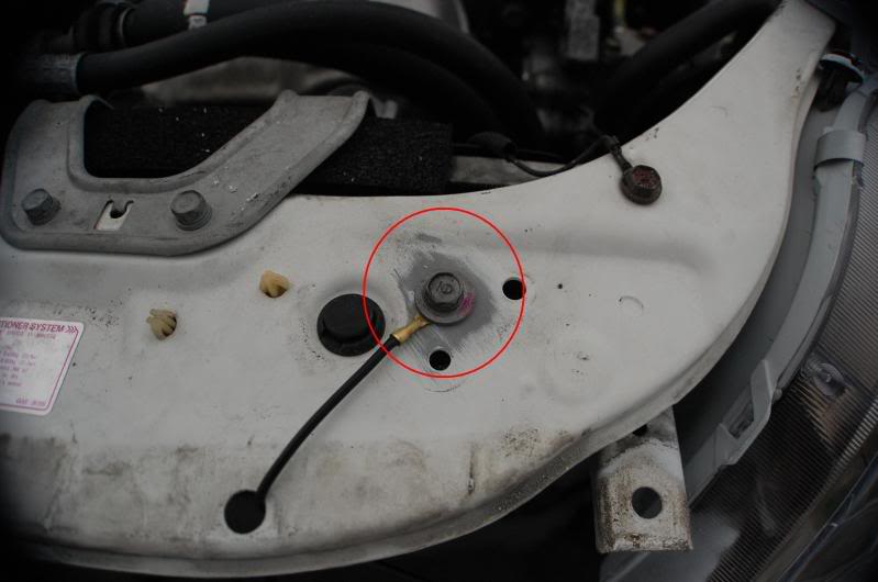

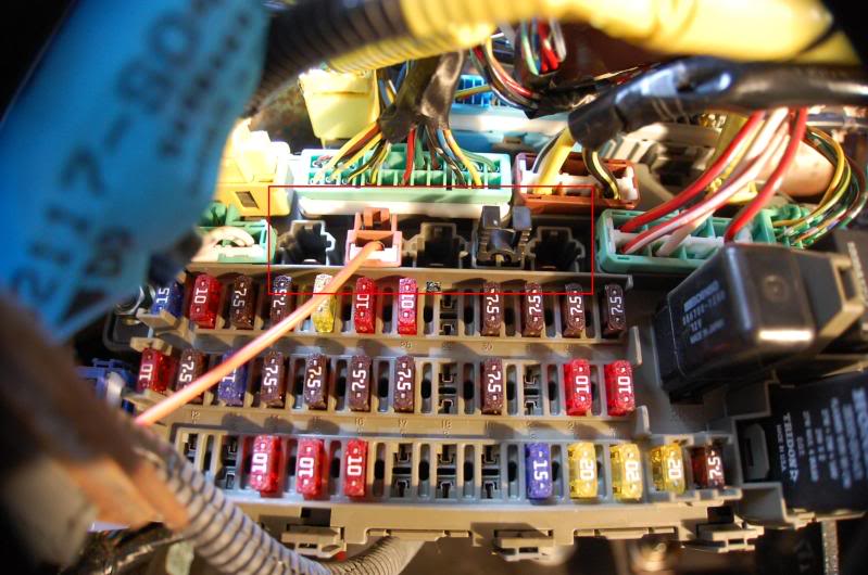

Man the depo kit keeps blowing the damn fuse!!! Here is where i have my grounds... where does the brown plug go on the fuse box? WTF... should have got OEM... these things havent even lit up once!!!! I have a 99 EX....

so u checked all ur grounds check and make sure u dont have a power wire touching a ground

power wires shorting to ground (not ground wires) is what causes fuses to blow. or faulty bulbs. take the bulbs out and see if the fuse blows. if not, then a bulb may be bad.
DO NOT replace with a bigger fuse. i can explain why if you don't know.

All the wiring came with wire loom around it... so i dont think the power is affecting the ground...

OK so i fixed it... all my connections were good. When plugging in the brown clip make sure you use the second open one from the left. This one will enable you to leave the switch on and they will turn off when you turn your headlights off...
