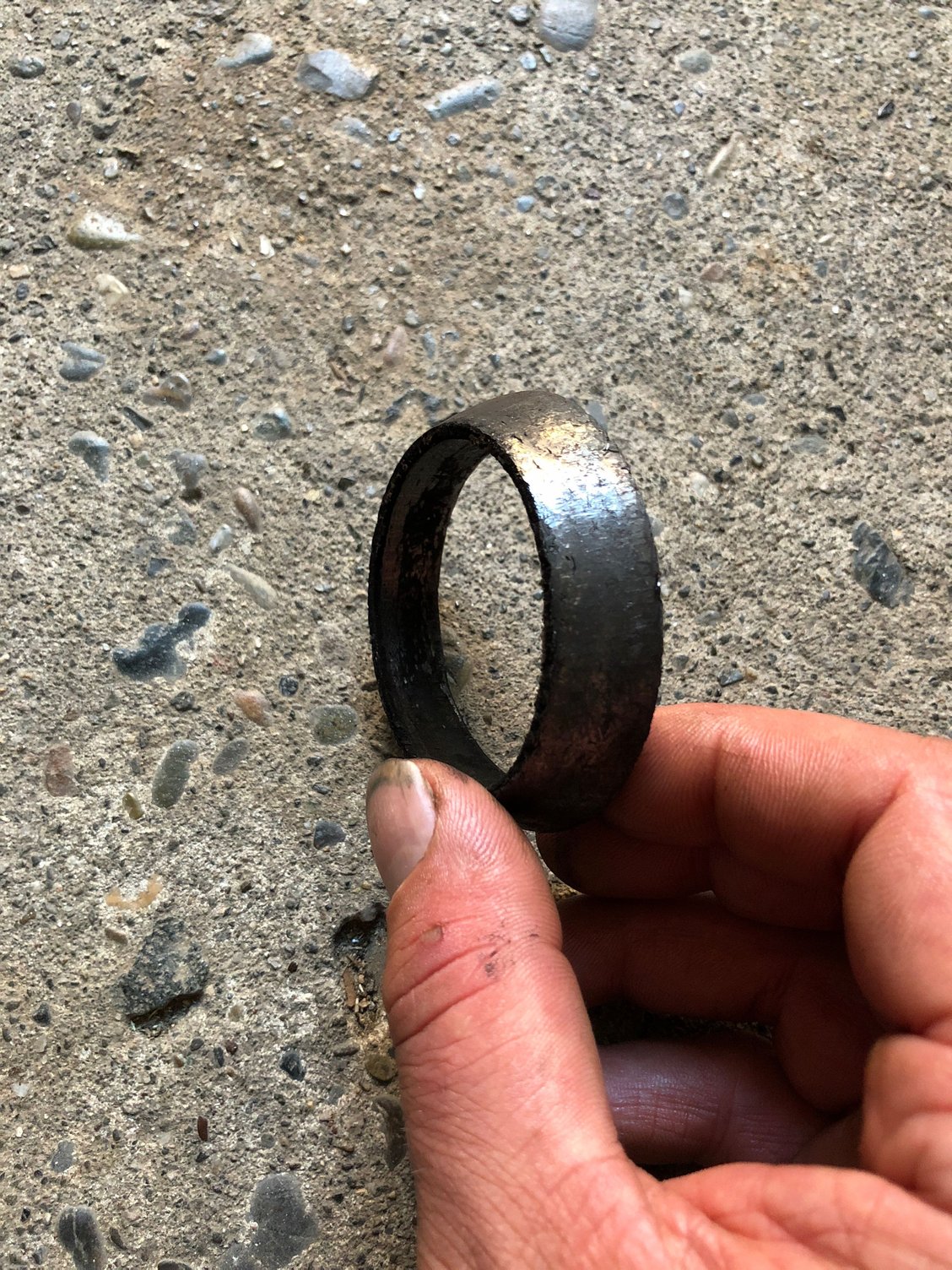

You need one of these in there:

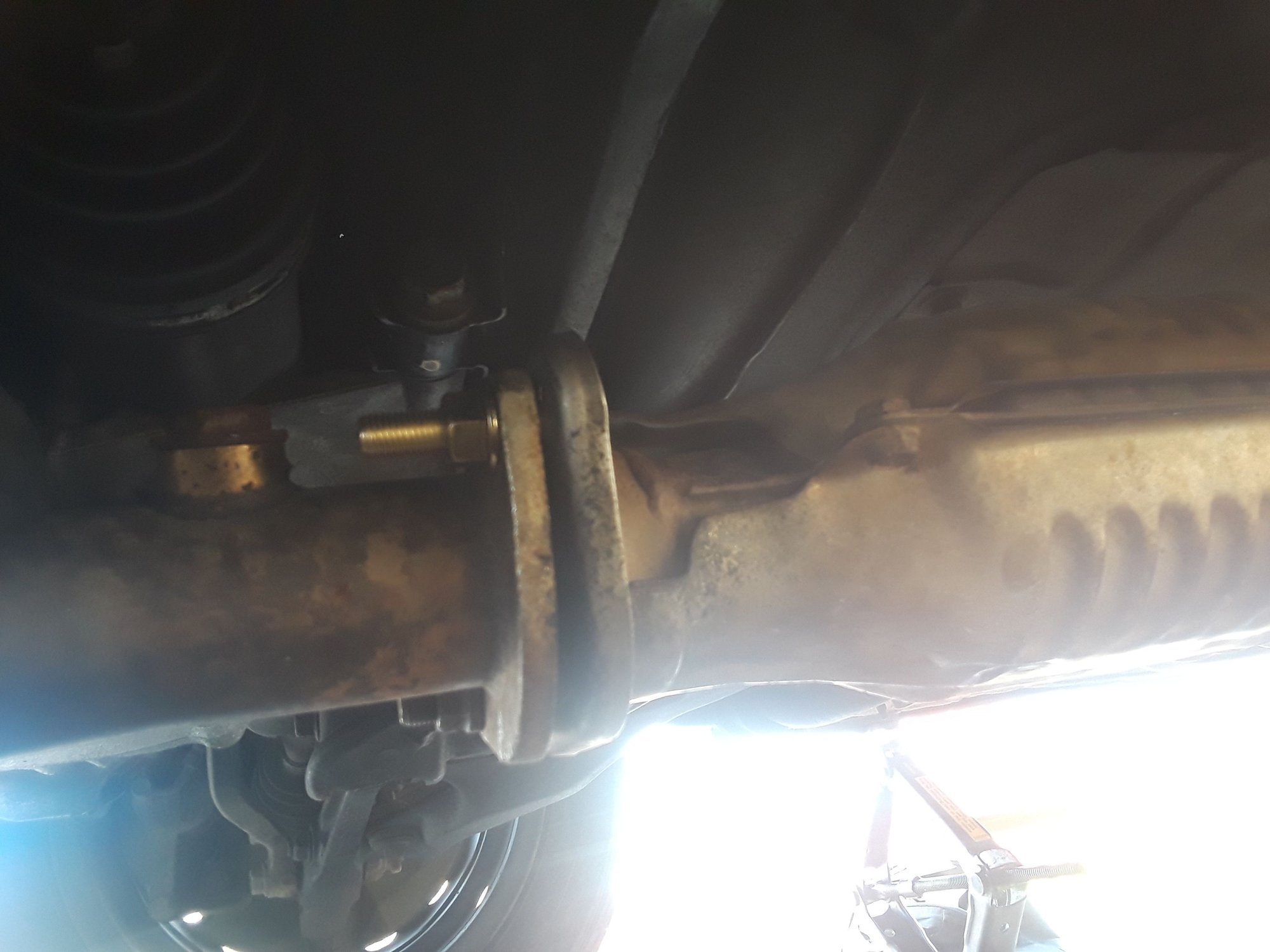

Like this:
The springs go on the left side of the flange, allowing the joint to flex
