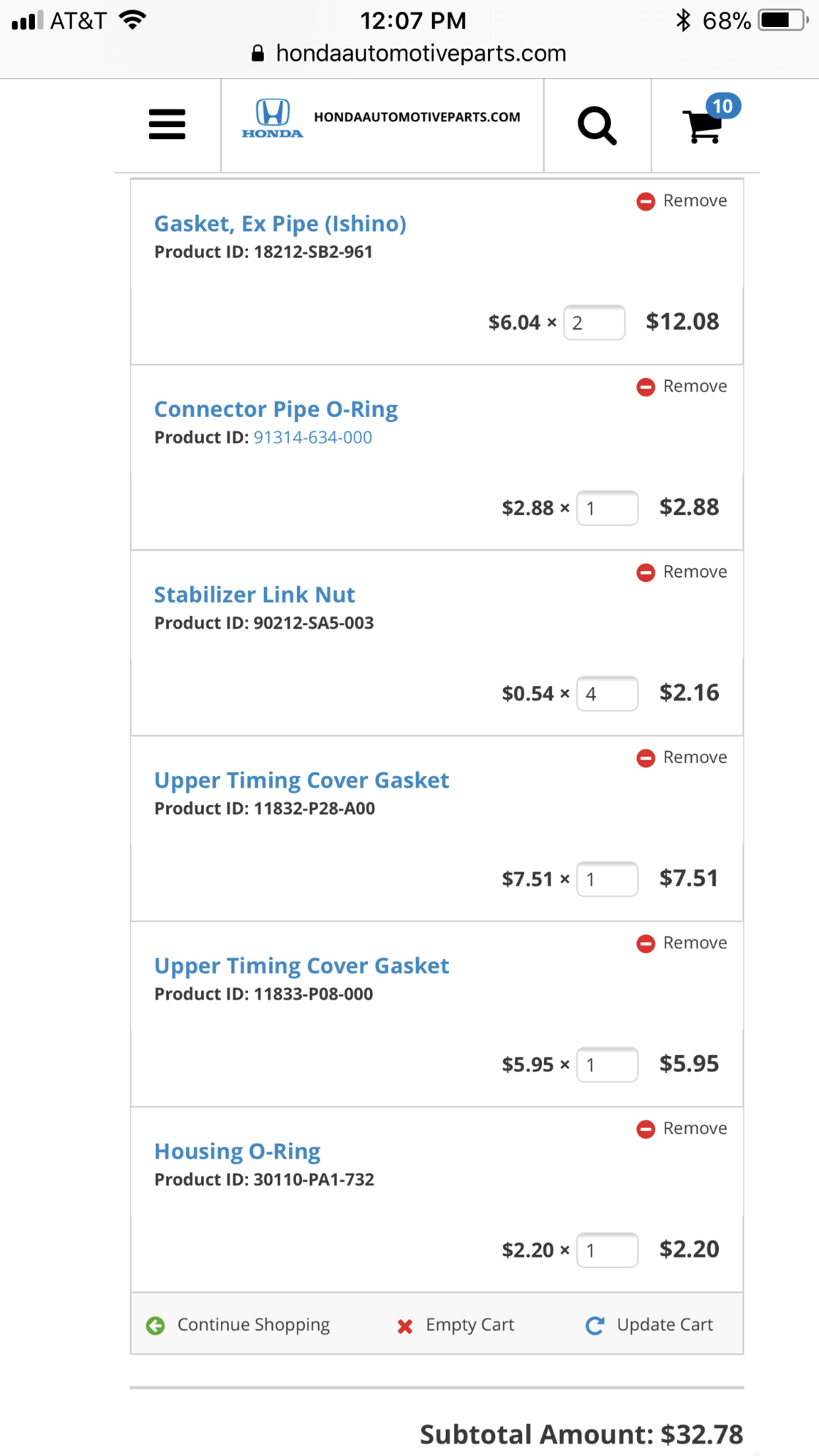

My parts list list from Majestic Honda, but you can do it cheaper. I’ve got 240k mi on the engine so while it’s apart I’m replacing the front main seal, the oil pump o ring, cam oil seal, distributor o ring, water pump, timing belt and tensioner and added a few odds and ends hoping I don’t need to get anything else(like a exhaust manifold bolt etc etc)
EZone- I know I didn’t need to order the h2o pump gasket after ordering the pump, And that’s the wrong one. My pump is a Yamada, the gasket is for the Keihin pump (Doh!) but it was $4. If anybody needs one, let me know I’ll mail it to you. Sacto.
