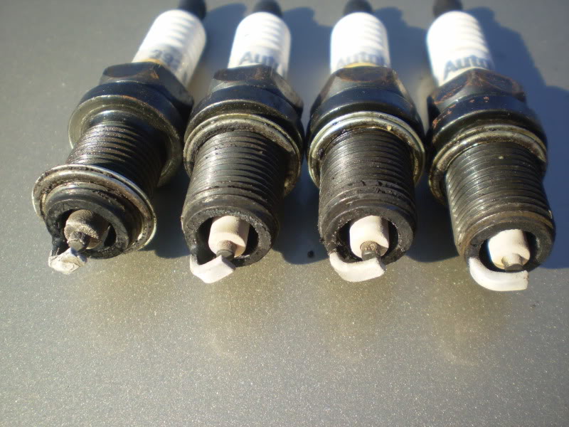

Got new spark plugs and wires but no difference.
could be a head gasket issue but i doubt it. Not loosing coolant from what i have noticed, no coolant in oil and no overheating issues. idle is pretty smooth right from starting, although some random misfires. idle is little high (about 900rpm)and it cant be adjusted any lower.
Cat or exhaust is not clogged. o2 sensor is also replaced. spark plugs were black and had little burned oil in them.

On all of them? Read this: http://www.aa1car.com/library/spark_plug_fouling.htm

Rechecked coolant, it has not lost any coolant or gained any in overflow tank. Will do a block test when i find a shop that does them.
All spark plugs were almost black before. Then i flushed piston rings and advanced timing a little to correct mark. It helped and run smoother. Now after 500 kms on highway all of them had a white tip and black ring. Similar like in the picture (not my picture though).

Did you first crank the engine a few times with the spark plugs removed after the piston soak or did you just install plugs and crank/ run engine immediately after soak? If you did the latter then the deisel fuel most likely cleaned the spark plugs during combustion.

well now i put the new spark plugs in, have to check them again after driving for some time
