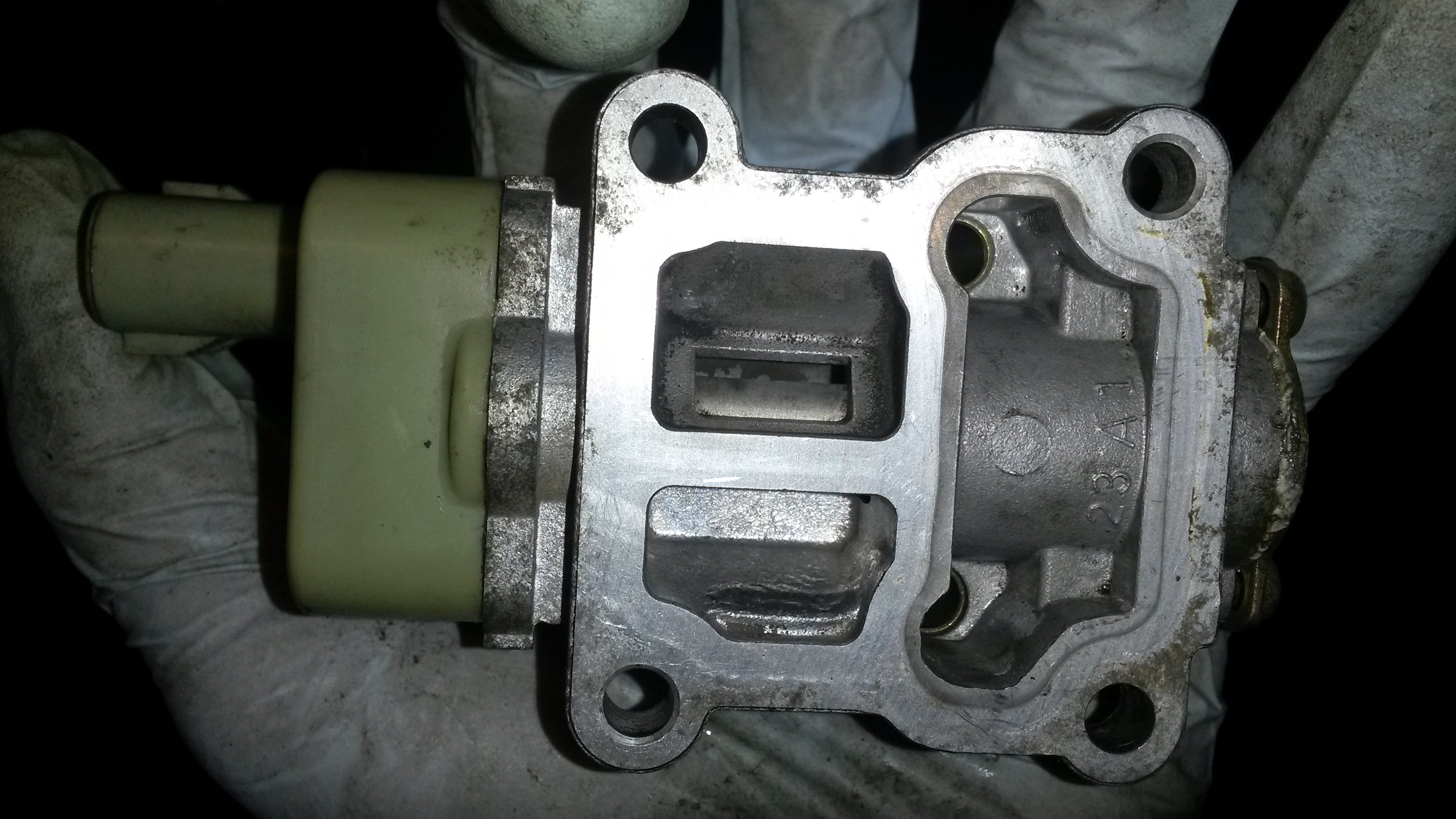

Removed the IACV and this was what it looked like, 200k miles since 1998..
Flushed it over and over again with solution until solution was clear coming out of it one way then another way then another, did this for like 20 minutes soaking and violently flushing until it looked like this..
Before disassembly, I disconnected battery surely resetting ECU in the time it took me to do everything. Then connected battery once reassembled. Then did the ECU relearning procedures (crank and let heat to operating temp five or 10 minutes, uncrank). The CEL stayed off for one day of driving 40 miles. Then tonight the CEL returned barely accelerating early in fourth gear downhill 40mph, engine was not quite operating temperature (was parked only a mile away), never have A/C on or anything turned on when CEL comes on, nothing turned on except headlights.
As for the feeling of stalling when idle, I think it has gotten better (not wanting to stall out as bad so maybe cleaning this wasnt a waste of time?)
Question: Did it look dirty enough to hurt my car's performance/efficiency?
Question/concern: When I tightened the four tiny bolts that hold the IACV in place, they just kept turning (ALL 4 BOLTS). I was barely tightening them because I read only do it 3-4 N*m. But I think i over torqued and destroyed every one of them. Seemed to hold snug though every turn (weird) but they all just kept turning forever. I should have removed the fuel rail for more room and feel but I didnt.
http://estore.honda.com/honda/parts/...&dl=206925#015
As for your O2 sensor, you can pull it out to see if it looks fouled or not. An 02 sensor socket would be helpful for that!

OP: if the bolts for the IACV are spinning freely then the IACV is loose and most likely creating a vacuum leak. There is also a paper gasket (IIRC) that is associated with the IACV and you need to make sure that is in good shape as well. As Poopies (him and I are not related though we are both online excrement) said pull the bolts back out and check to see if the threads are stripped.. and hope that it's just the bolt threads that are stripped and not the mating surface's threads or you'll have some heli-coil(ing) to do.
Either way the IACV is not causing the codes but regardless needs to be mounted correctly.

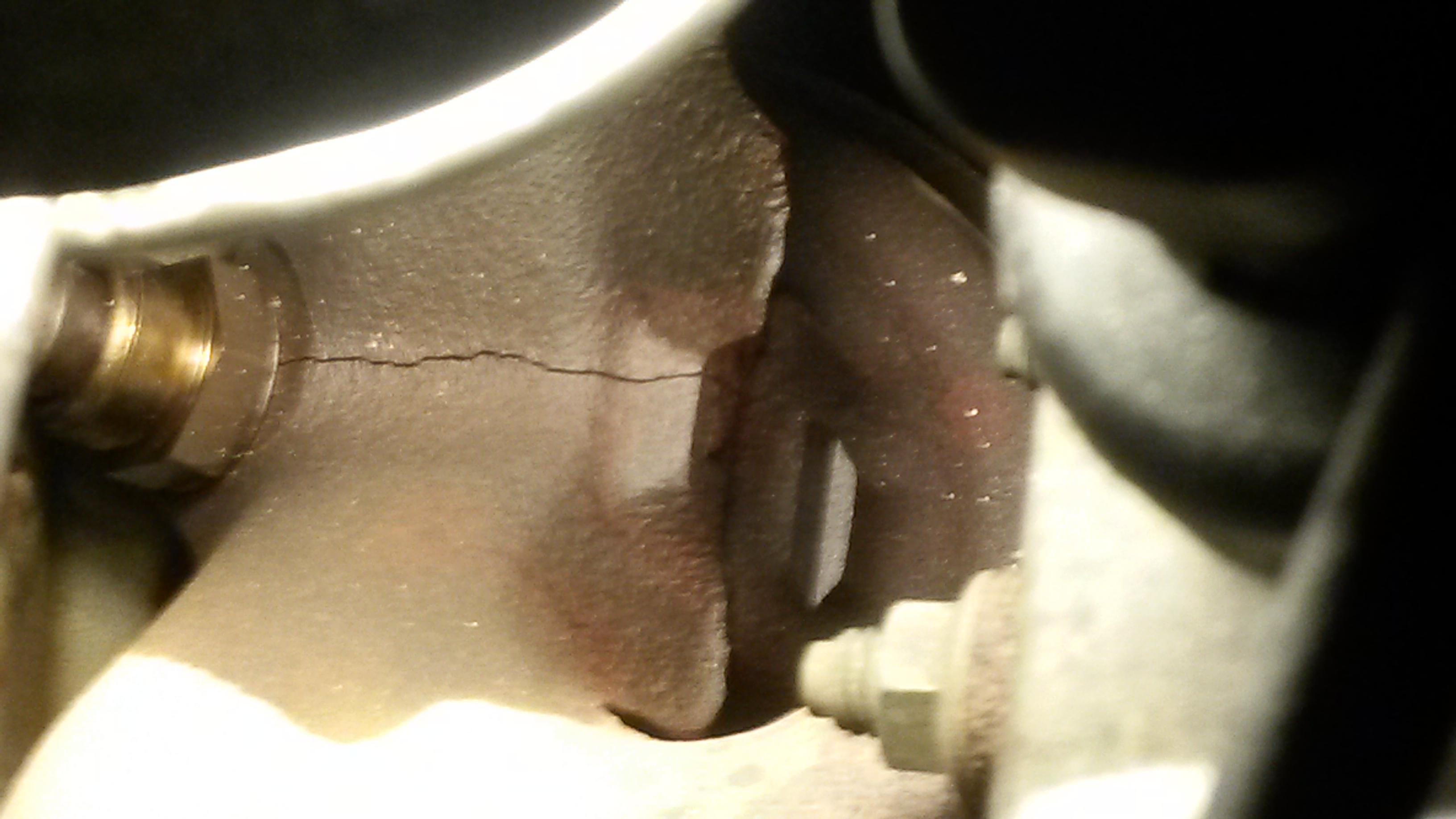

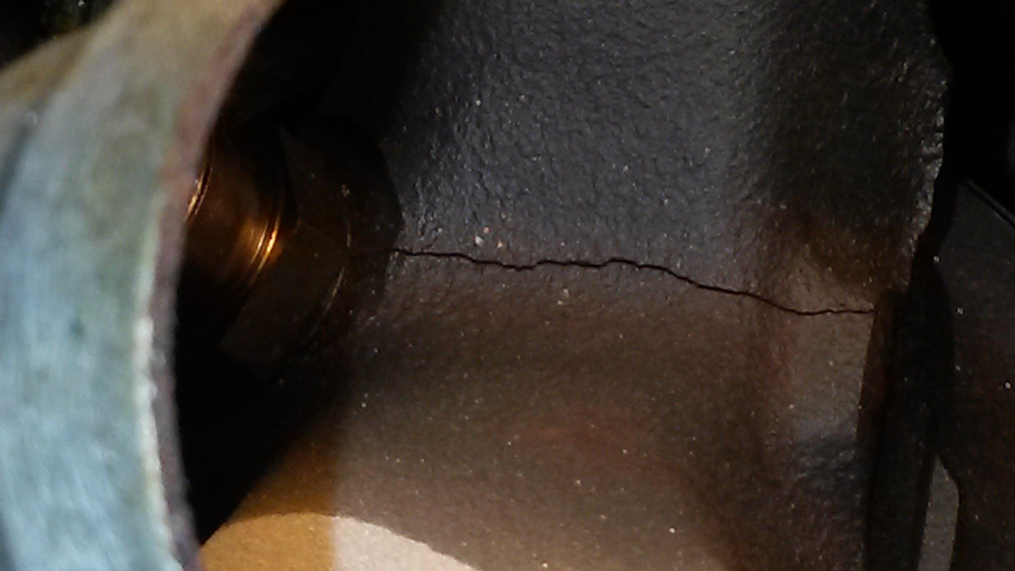

Was doing going to do what ezone said and then try replacing the O2 sensor since I have a spare new one when I noticed the exhaust headers/manifold has a crack a few inches before and leading right up to the first O2 sensor. I've never removed the heat shield on this car before tonight. The crack is on top, very visible right after removing heat shield I noticed immediately.
I think this crack is the likely cause for the P0172. Can someone confirm? I did not replace the O2 sensor with my new one after finding this crack. Because I dont want to install it then weld or replace then have to reinstall. What do I do about this crack? Weld or replace headers? If replace, I would like to know what headers are best for my D16Y7 engine that won't crack like this. I have a DX Civic which I've read has different exhaust config than an EX. Is an EX config superior and should I go ahead and convert to EX headers + cat? I have a stock exhaust system right now.

When it comes time to fix the crack in the manifold, it's only gonna take about 14 extra seconds to remove the new sensor so don't let that stop you from changing it now.

O2 sensor only senses o2 molecules, right? The crack allows exhaust gas to escape before reaching sensor. That means less o2 molecules in the gas mixture hitting sensor. That why I thought the crack is likely the cause of p0172 (rich) reading from the o2 sensor. Because of this rich reading, the car is actually running LEAN because the computer gets info that exhaust is rich then injects less fuel. Which could be why my car stalls out idling I'm thinking. Because of lean mixture theres not enough fuel thanks to misinformed computer. Misinformed by the o2 sensor because of the crack.
Am I misunderstanding? Please say whether my logic is wrong and correct me. A question I have is would this crack introduce/suck in any engine bay air to the manifold or just let gas escape?
Re: CEL & P0170 & P0172, Running rich, Sometimes feel like going to stall when in Neu
You see hear and smell that a cracked exhaust manifold leaks exhaust out, but you don't see that it also allows fresh air to enter through the same crack under certain conditions (reversion, pulsation), thereby causing the sensor to read (falsely) extra oxygen in the exhaust....at times. Maybe all the time, IDK.
That alone does not cause the sensor to fail nor become inaccurate.
It DOES skew the accuracy of what the sensor is reporting to the computer though.
The computer responds to the O2 sensor input as programmed.
The sensor reports as though the engine is lean (high O2 = lean), the computer adds a bit of fuel injector duration until the O2 sensor gives its desired output. (basic feedback circuit)
IF the computer reaches the limit of its acceptable values to add to the basic calculations for injector duration (seen in short term fuel trim and long term fuel trim values) it will code.
The cracked manifold generally causes the system to go leaner than stoich.
The computer adds fuel until it THINKS it's in stoich- but it's false. If it's so bad it reaches its threshold fuel trim value (+19% or 1.19 depending on the system/scanner used) for enrichment, it would code P0171 lean.
Problem is, P0172 is a rich code.
Long term fuel trim had to exceed -16% (0.84) to set P0172.
Those engines had issues with the primary sensor going "numb" for periods of time, long enough for the computer to go nuts with fuel delivery but sometimes not long enough to code for a sensor problem.
If the primary O2 gets stuck at a high voltage (rich value), the computer pulls trims down trying to get the desired response from the sensor, but since the sensor is stuck it can't respond. The computer has the ability to add or subtract enough fuel to bog the engine.
Then when the sensor starts working again or the computer defaults to open loop again, the bad running suddenly stops.
THAT'S why I said to unplug the primary sensor and drive it a while first, back in post 3.
Cam timing, tight valves, inaccurate MAP reading, wrong injectors, and more could cause a rich code too.

Replaced exhaust manifold and cat assembly with new assembly that had oem specs even though aftermarket. Replaced upstream O2 sensor with a brand new NGK 24542. Reused downstream O2 sensor in downstream position once I finally got it loose from old cat. Reconnected battery after doing everything and did the ECU relearning procedures. And the CEL returned after a few days of driving with the same codes like it always does.
So, ezone was right. The crack before the sensor wasn't causing the P0172. Brand new exhaust manifold, cat, and upstream O2 sensor. This was an expensive way to find out for sure and was my fault.
Now it has to be fuel related?
Rediag for the code you have now, readjust your thinking cap

I had a smilar crack on my first 6th gen Civic manifold and it never threw a code. Don't gloat over the repairs though. The crack needed to be fixed (replacement) as you don't want to smell rotten egg farts everytime you drive you car, as well as eventually damage the CC. Never a bad thing to replace an o2 sensor on a high mileage car. The o2 sensor combined with CC replacement should increase gas mileage a bit.

I'm thinking about buying a new upstream O2 sensor, given the codes are saying "Bank 1". Does it sound like it Could be the problem? Any reason why it wouldn't be considered for fixing the problems Im having (It never has in the liftetime of the car and has been 200k miles). Its only $35.
Use this link to plug in your car's particulars:
I did mention earlier if the IACV's block mounting holes are stripped..you will have some heli-coiling to do. If you want to cheap out or lazy out you could try to go up in nearest size standard bolt in the current hole... just make sure to use correct pitch, length and highest heat tolerant metal possible.
