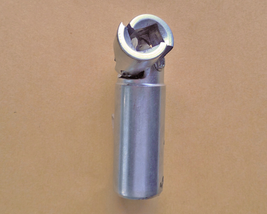

They do make a pretty loud crack when they loosen but immediately are loose with no drag. So they probably were not seized. You probably just didn't put enough umph in it. I know that filling however.
A 15" breaker bar with as much umph as loosening a tight lug nut is not enuf umph? Any more umphhh and i'd either strip the aluminum threads or shear the Spark Plug in half. Attached is a photo of the Spark Plug socket that made a loud crack when it broke. Thankfully the socket broke and not the SP. It will eventually loosen ... i'm in no hurry. In fact I'll keep using the original Denso Platinum Long Life plugs as long as the engine keeps on purring, accelerating with smooth steady power and great gas mileage. For all we know an Ignition Coil may need to be replaced before the Spark Plugs. If the engine's performance is still AOK at 150K i'll keep using the original plugs until one of the Denso plugs starts to misbehave.
IMO most Motorheads are generally too obsessed with changing out Spark Plugs (that don't need replacing) for the latest trend (e.g. Ngk Iridiums). Some probably change perfectly good plugs before 100K ... we just can't keep our fingers off the engine. So, call me a killjoy
