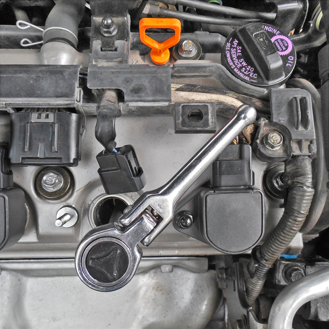

Ingrid suggested using a length of reinforced rubber/polymer hose that slips over the seized plug. When inserted down the metal tube it should make a snug fit over the hex shoulder of the plug when pressed down tight against the aluminum head. First spray some PB Penetrating Oil around the bottom of the plug (not too much) and let it sit for 10 minutes before securing the hose to the seized plug.
Be sure to have a small funnel handy and wear a good pair of insulated gloves. With the engine warm/hot (180-200 F) pour liquid nitrogen in the funnel ... enough to fill the hose (4 inches) so it doesn't boil out too fast. As soon as it boils dry repeat the process again. Then immediately remove the hose and quickly insert the Spark Plug socket with extension using a 25 inch Breaker Bar (not a 6 foot cheater pipe) and the formerly seized plug should easily unscrew without stripping the aluminum threads or shearing the plug.
Ingrid was formerly a competitive Gymnast and now enjoys rock climbing. Attached is a photo of a portion of an old painting of a rather fancy Swedish birthday party. Ingrid's great, great grandmother (Linnea Jansdotter) is the girl with her left hand gripping the blue bench and her right hand gripping the table top. Linnea was a natural born tree climber. Apparently she passed on some of her DNA to Ingrid.

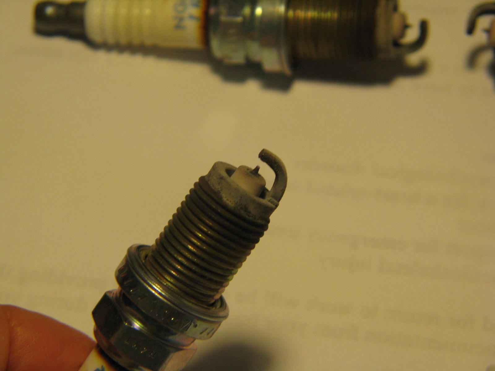

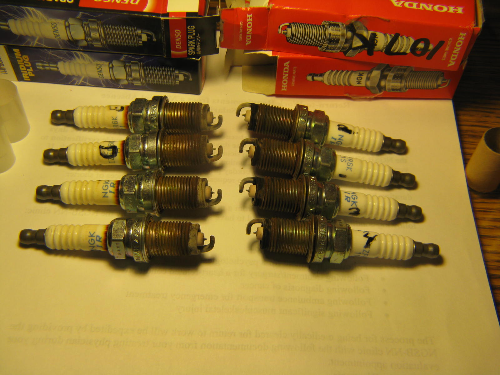

Gee guys. If the plug is truly seized and when you pull on a standard 1/2" drive 14" long breaker bar and the plug does not get free after turning it just a tad. Leave it a alone. Theses plugs will probably go 200,000 miles easily. Know I put them in my Civic and CRV but rest assured, it will be the last set. Interesting how the CRV NGK plug has a little leakage. Think it had 87K or so. The Civic had 107K. Both plugs have wear in the gap. However, the ignition system can easily fire twice that gap. I have had two other Honda's I have put plugs in and not sure why anyone would have trouble. However, if they had already been changed before and someone bottomed the crush washer and then turned another 1/4 turn, the aluminum threads would probably strip and weld to the steel threads. Bring this plug back out would bring all the aluminum threads back out. Unlike that stupid long plug in the Ford truck that actually broke into, this plug is not going to break. However, if you do not support a proper rubber lined spark plug socket square, you can break the porcelain.
ID:	87876   Click image for larger version
ID:	87877   Click image for larger version
If you're talking about the brownish stain just above the metal hex, that's not leakage. It's a Corona discharge stain.
LINKY-CLICKY: http://www.ngk-sparkplugs.jp/english...q17/index.html
Measure the gaps in a couple of the used plugs, see if they are still close to 1.1mm (.044")?
I bet a plain cheap copper plug starting at .044" would have its gap eroded away to .080" or .100" after trying to run it for 100k miles.
Or pulled the plugs out to inspect them and put them back in.
Hoo boy that would sure strip threads.....and I know a few people that would do it because the instructions say to 'tighten another quarter turn after making contact', never taking into account the crush washer was already crushed once.

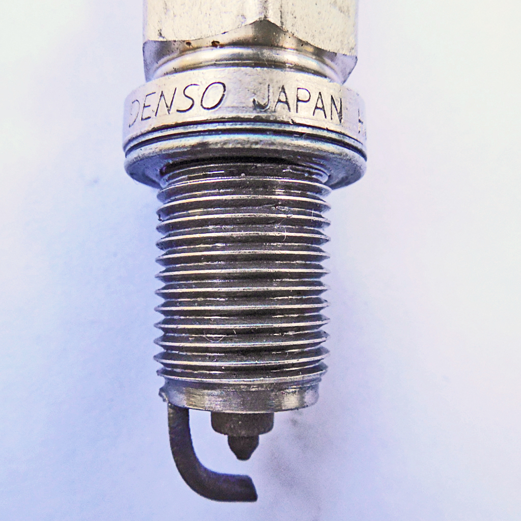

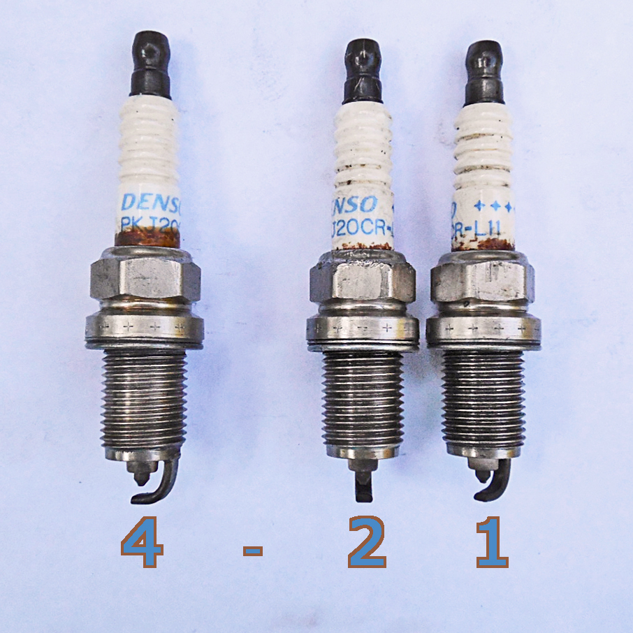

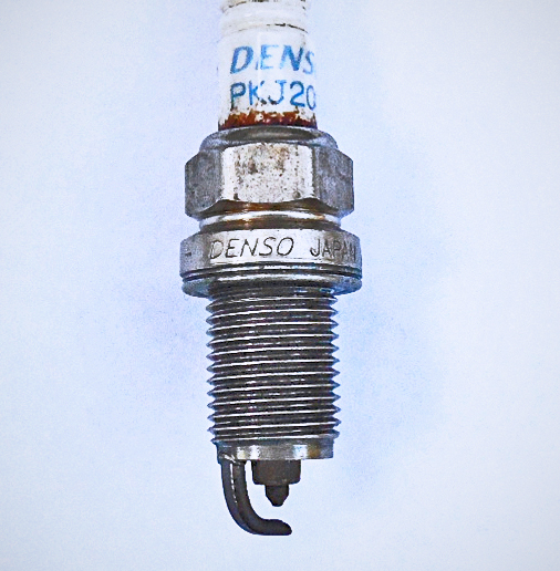

Gee guys. If the plug is truly seized and when you pull on a standard 1/2" drive 14" long breaker bar and the plug does not get free after turning it just a tad. Leave it a alone. Theses plugs will probably go 200,000 miles easily. I put them in my Civic and CRV but rest assured, it will be the last set.
AGREE ... as long as engine, gaskets, seals, etc are maintained in good condition. WHY chance stripping the threads or worse yet having to remove the head. At 126K the engine purrs at idle, accelerates smoothly and got 42 mpg (tires at 37 psi) on a hgwy test cruise shortly after taking ownership. Have since lowered tire pressure to 32 psi, but still feel every little pavement break. Honda mechanic says the struts are OK.
Leave well enuf alone is a good motto, but as we all know it's not easy for us Motorhead Mechanics to keep our fingers off an engine. After buying this one owner 2002 Civic two months ago i discovered the two middle plugs were seized. Had pretty much given up on #2 plug after a soaking with PB Penetrating Oil, breaking it loose but no more than 1/4 turn (CCW, CW, CCW). Gave it a few more PB soakings every couple days for a week, with some gentle hammer tapping using the plug socket against the aluminum head as well as the hex shoulder of the plug. Still wouldn't budge any further even with enuf torque on a 15" Breaker Bar that would remove most wheel lug nuts.
Even though i was resigned to ... "leave well enuf alone" ... decided to try again after 3-4 weeks had elapsed. Surprise-surprise #2 plug came out easily as if it had never been seized. The engine was warm (not hot) having been parked for about an hour. So, that experience has motivated me to occasionally keep trying to free #3. I've been able to break it loose, but only 1/16 of a turn at a time (CCW, CW, and CW again) using a 14" Breaker Bar. Hoping that sometime this summer with some occasional PB soakings every 3-4 days it will finally relent.

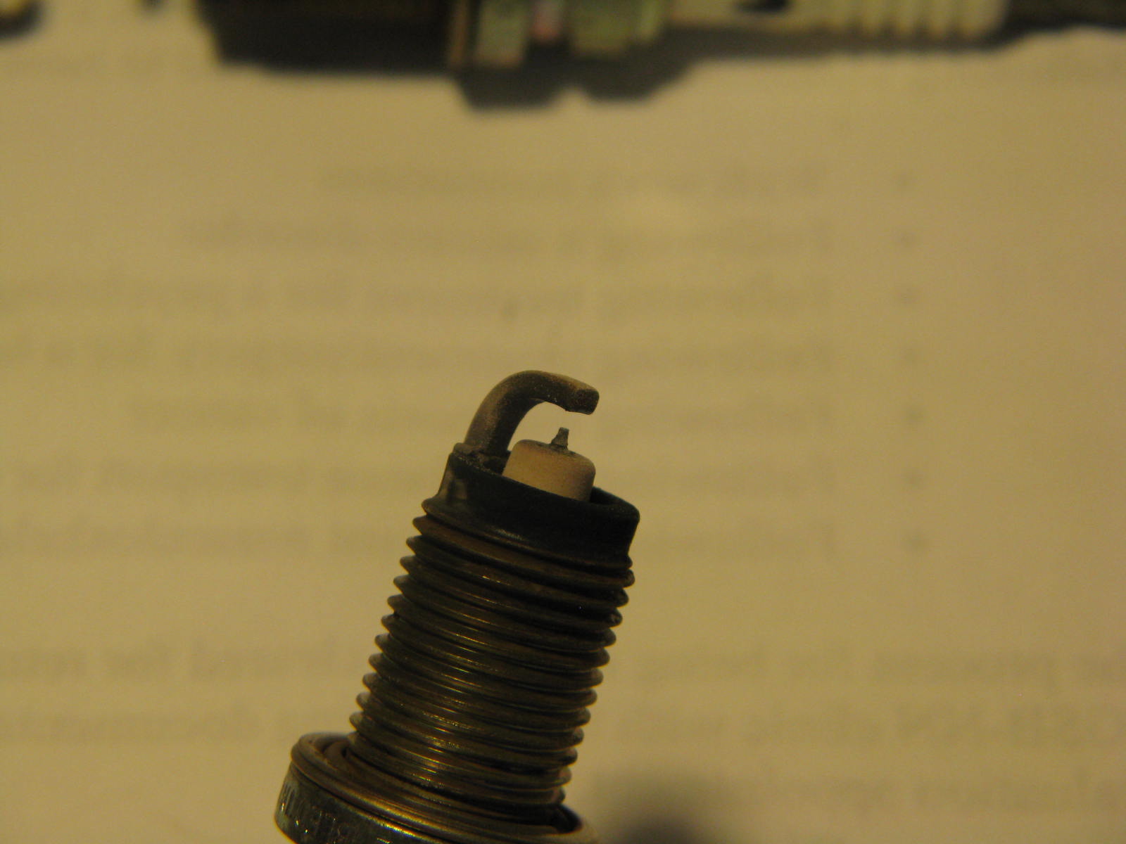

Attached are three photos of the original DENSO PKJ20CR-L11 Platinum Long Life plugs. All 3 still have a .44 gap. You can see the evidence of my hammer tapping on #2 using the SP Socket on the plug's hex shoulder by placed the SP Socket so it was resting on hex shoulder instead of being around it.
Name:	Third Spark Plug Seized.jpg
ID:	87885   Click image for larger version
Name:	DENSO PKJ200CR-11 Platinum Long Life copy.jpg
ID:	87886   Click image for larger version
Name:	DENSO JAPAN ++++ - - - -.jpg

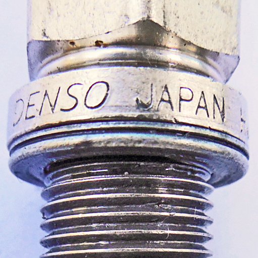

MN-02-CivicEX. Think your plugs were original to motor? I followed Ezone's thread above in post post 37 for NKG Corona tracks. It also had some other info on knock off NKG plugs. Your's look strangely off color to a real NKG. Almost like a Champion rebranded. Old Champions were great plugs in cast iron but were not worth a flip in aluminum.
My local Honda Dealership generally agrees that the steel in today's Spark Plugs made in America or China (e.g. NKG) are not as high of a quality as the original Denso plugs in my 02 CivicEx. My 02 CivicEx was assembled in Marysville, OH with "DENSO JAPAN" PKJ20CR-L11 Long Life Platinum plugs. Ezone gave me the impression he had never heard of a Denso "PKJ20CR-L11" before my mention of it to him several weeks ago.
If anything one of today's comparable NKG Long Life Platinum plugs is of a lessor quality and would be more of a knock-off of the superior DENSO than what you proposed. Just because a NKG comes in a handsome Honda cartoon is no proof it's of a higher quality steel than a
"PKJ20CR-L11 Long Life Platinum" plug with 126K miles. It's more likely a comparable NKG Long Life Platinum plug would've sheared off with the same torque that these two seized Denso plugs have had to endure. The quality of manufacturing in today's NKG plugs whether in America or China are knock-offs compared to the quality of the steel in the PKJ20CR-L11 Long Life Platinum plugs. That's just one reason why the gap in these plugs is still .44 after 126,000 miles ... even if you're still a skeptic.
Am attaching an even closer macro photo of one of these plugs so you can clearly see "DENSO JAPAN" stamped around the side of this superior quality "Long Life Platinum" steel plug. Have also attached a photo of the Spark Plug Ratchet that Ingrid uses so she doesn't over-tighten a plug and damage the aluminum threads. As a competitive Gymnast and Rock Climber Ingrid probably has a stronger grip than either You or Ezone. She whoops me when it comes to arm wrestling
Name:	DENSO JAPAN +++++ - - - - -.jpg
ID:	87889   Click image for larger version
Name:	Ingrid's Spark Plug Tightening Ratchet Tool.jpg

It would have taken Rock Climber Ingrid with that short ratchet to have cracked the torque on my CR-V. Even with my long 3/8 breaker bar, they made a loud crack breaking free. Obviously they were torqued past the washer crush. However, as soon as they broke free, they would turn out by hand on the extension. Engine was built in Japan and car assembled in England. I put Denso back in it since I had assumed (wrongly) that was what was in it from previous Hondas
