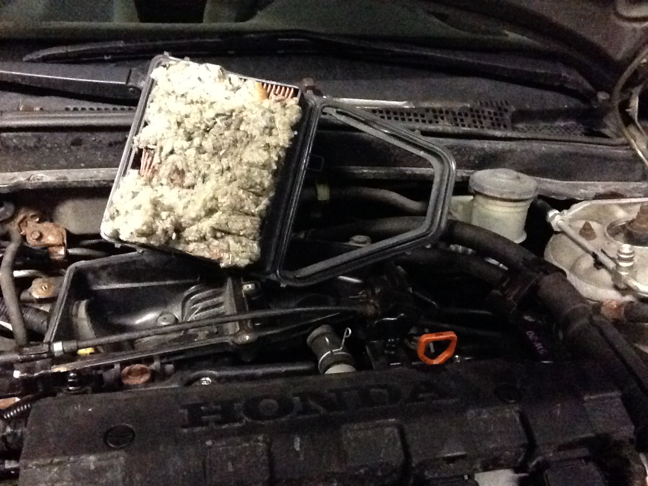

I got my ground straps off the engine tonight. Are there just two? Thermostat housing and the top of AT? Going to pick up replacements from Honda.
Noticed this while removing air box.
I hate mice!!!
That could limit performance, an air restriction LOL

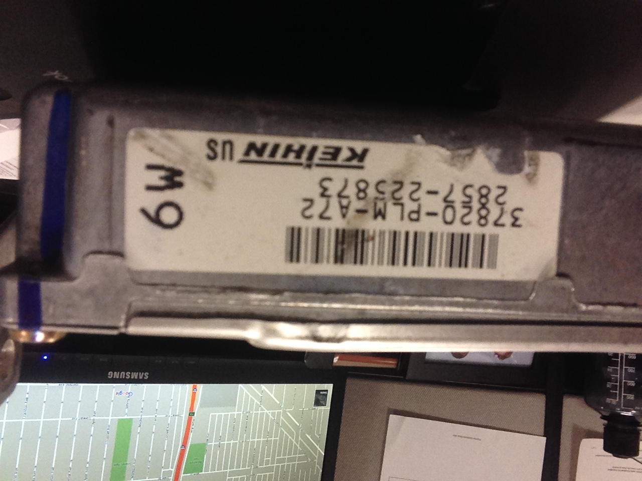

Re: Timing belt aftermath...
Pulled the PCM today. It's a 37820-PLM-A72, so the A76 that the dealer gave me from my VIN just a newer revision?
Old Feb 21, 2016
37820-PLM-A76 is the newest part number, updated from the A72 in the car now.

What does the second line of numbers on my PCM signify? Below is a picture of the PCM out of my car.
I found an A74 at a local yard, anything else to match up?
Old Feb 22, 2016
Nothing of importance to me.

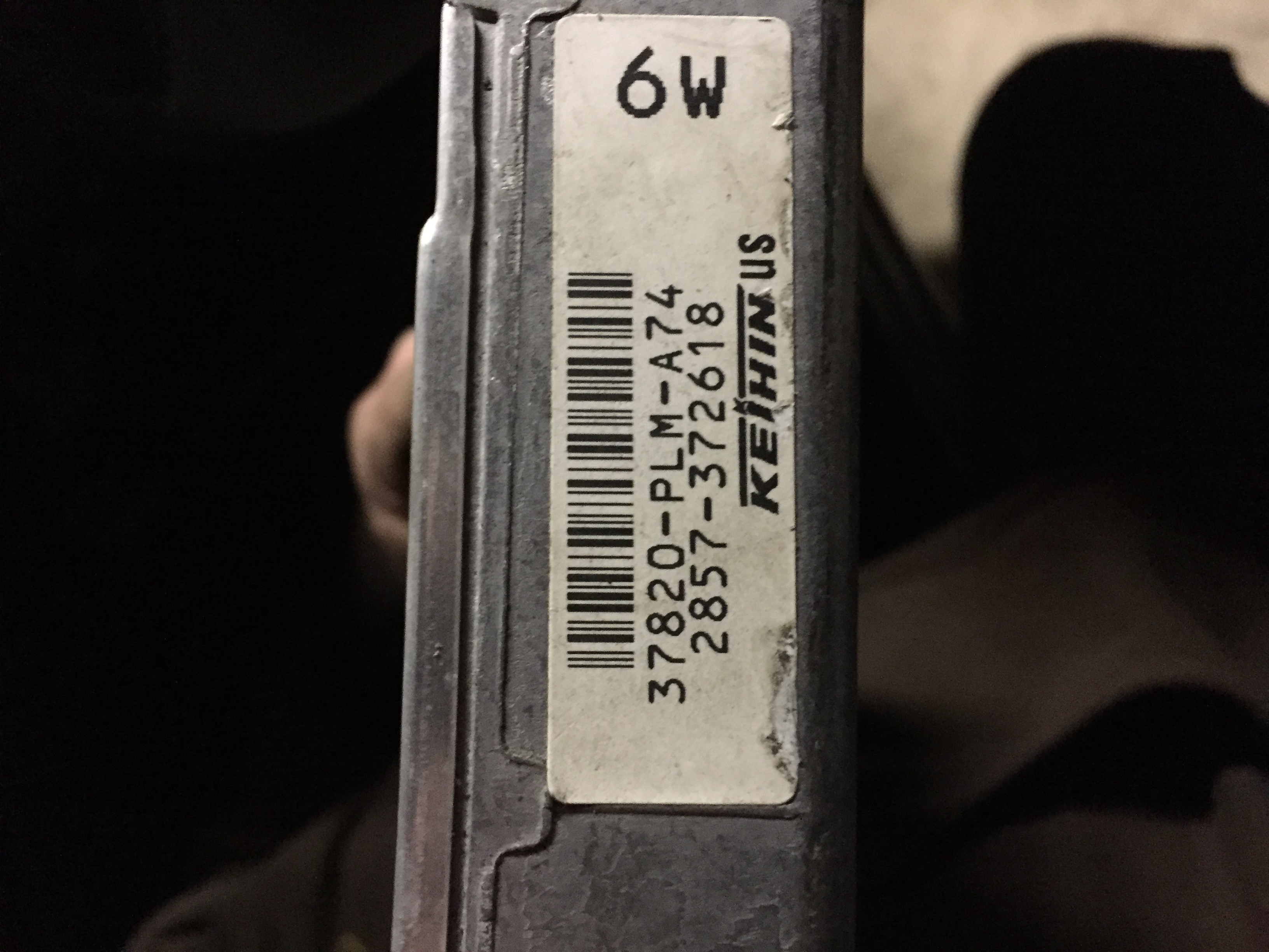

Got the civic all back together last night. Installed both new ground wires, polished and greased all alternator mounting points with dielectric grease. Installed the replacement computer (tight fit) and had car towed off to the dealer
Here is decal from replacement computer out of 05 Civic
