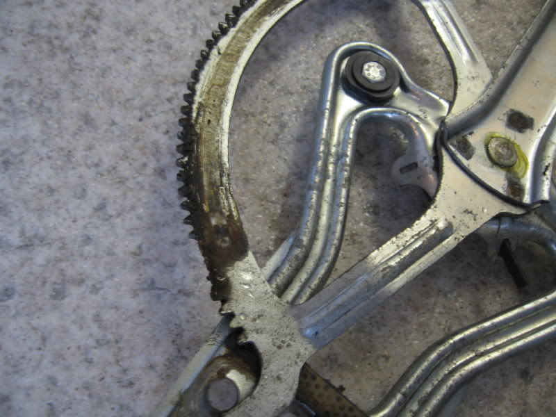

For lack of a pic of a real Honda regulator, I found this on a goggle search... Shows the stripped teeth on a basic scissors type window regulator

wow.....just saw the pic.......it gives me something to look for now.......that was awesome for a visual.......that sounds like the issue.......but if you got more up your sleeve, throw it at me!!!!.........that pic makes sense though!!!!

Like I said that wasn't a pic of a Honda unit, yours will be quite different once you can see it. I just grabbed the first pic I found with stripped teeth.
Yours would probably look more like this once you can see it
You will most likely need to take it all the way out of the door to see the stripped teeth too.
Maaaybe you could use a mirror and flashlight to see something, but I don't remember ever trying that.
