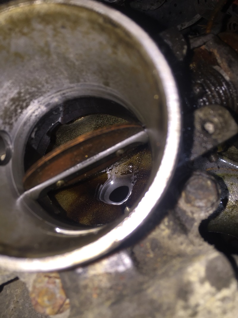

There is oil in the intake manifold looking down the throtte body. I took some pics a while back and it totally escaped my mind until you mentioned it.
Didnt check the PCV valve, she is driving over tomorrow and I can then.

Re: Valve Seats or Piston rings?
Originally Posted by btungcab87
Baffle in the breather tube area? Thats a new one on me sorry haha
I think you might always have a little bit of oil in an intake, they are not perfectly dry.
The breather tube in the valve cover....if it were a big open hole then oil could be free to enter the tube, and that tube is connected to the air intake snorkel.
There should be some sort of covering inside the valve cover to keep it from getting liquid oil in the tube.
Just flailing in thin air here. You could disconnect PCV and breather tubes for a short test drive to see if smoke quits.
I think it'll be a combination of rings and stem seals
