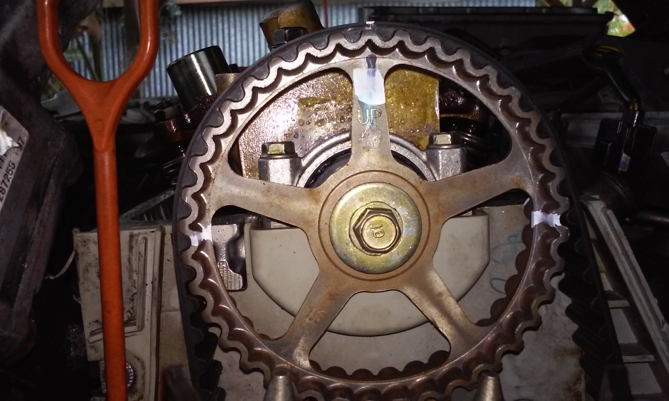

Questions concerning proper timing alignment:
Scenario question:
a, Engine at TDC,
b. timing gear (behind crankshaft pulley) mark is in line with oil pump arrow (stamped on block),
c, crankshaft pulley timing marks align with pointers on lower timing cover
d. cam gear "UP" mark is not at 12 o'clock position
Does this mean timing may have skipped a tooth/teeth?
How to get the cam gear "UP" mark back to 12 o'clock position and in line with the timing gear & crankshaft pulley marks?

the "up" mark is not the timing mark, thats just a general indication,
the timing marks on the cam are very small dashes like this - one on each side of the cam pulley, they should be in line with the cylinder heads upper surface with the valve cover removed,
how far off is the "up" mark?
if the "up" mark is 180 degrees off and at the bottom, then you need to rotate the crank one full revolution, the cam only turns once for every 2 crank revolutions

the "up" mark is not the timing mark, thats just a general indication,the timing marks on the cam are very small dashes like this - one on each side of the cam pulley, they should be in line with the cylinder heads upper surface with the valve cover removed,how far off is the "up" mark?
In most of the DIY timing belt threads and videos I've reviewed describe when installing a new belt:
Make sure timing gear mark is aligned to pointer on block. Crankshaft pulley marks are aligned to pointers on lower timing cover. Cam gear's UP mark is at or very near 12 o'clock position and the two marks behind the cam gear are parallel/even to the cylinder head with valve cover off.
For almost the entire time I've been going through the timing belt retensioning process the UP mark would always land a noon position when crankshaft pulley mark aligned with pointers at TDC, However, the last time (yesterday) I tried to retension it I held my hand on the cam shaft gear while slowly turning the crankshaft counter clockwise. Held my knee on the socket wrench (crankshaft) for tension and tightened the tensioner bolt. After manually turning the crankshaft to TDC the cam's UP mark is now at the 10 or 11 o'clock position... crank pulley mark still at proper position, I don't plan to mess with it further until timing kit arrives.
If the timing gear happened to jump a tooth is it just a matter of getting back to TDC, removing the timing gear and reinstalling it so the mark lines up eith the arrow stamped on the block? By the way I couldn't see that arrow when I pulled the harmonic balancer/crank pulley. Does every block have one?

line up the crankshaft marks.....take a picture of the marks, then take a picture of the camshaft position/marks, and post them here

Do you seriously not remember the info and picture in reply #39?
Isn't it incorrect and possibly damaging to spin the cam with the timing belt off?
I can spin a camshaft all day long ---as long I know the positions of each of ALL of the pistons are such that no interference (contact) can occur between pistons and valves.
You, on the other hand, might not want to attempt this without more thorough research.

Seriously though, I do remember you saying the UP mark is not a timing mark and I get that.. but, if you're a noob like me and you're looking through threads and videos and everyone is saying line up timing gear, line up crankshaft pulley marks, and put cam's UP mark straight up (noon) at TDC then that's what a noob expects to happen. True TDC is when piston 1 is at it's peak and I have used a long screwdriver in the spark plug hole + check with a flashlight to ensure that, rather than relying on the cam UP mark.
Is it fair to say that ideally the UP mark would land at 12 o'clock at TDC even though it's not a timing mark?
Where's your service manual?
Is it still in correct time?
And here is where the root of my problem lies. Inexperience leads to insecurity. which leads to doubt, which leads to a lot of over-thinking, that leads to me looking like a fool here..lol.
In a nutshell: With the timing belt removed:
Rotate the crank 90 degrees away from the TDC mark,
All 4 pistons will be mid-stroke, no valves can make contact.
then it's safe to spin the cam wherever you want.
Align cam gear timing marks with the flat surface of the head as described earlier.
Then turn the crank back 90 degrees to where it began.
If you continued to turn the crank 3/4 turn to tdc again it would flatten any open valves as two wrong pistons go to the top of their strokes..

Not sure if it's still in correct time because currently both timing covers off (no points to align with) and crankshaft pulley is on ..due to what I described in previous post when I was trying to isolate if the tensioner or loose timing belt was causing the knocking noise. I'd have to remove the crankshaft bolt and pulley to check timing gear to verify.
So, to be clear when you say: back 90 degrees that would be in clockwise or counter-clockwise rotation? Also to be clear I do know the engine operates in a counter-clockwise rotation.

I can figure it out with no covers.
I can find #1 TDC without marks (close enough for government work anyway)
and the marks for the cam are always there.
Don't overthink this..
If you turned the crank a quarter turn away from the TDC mark, there's only one way to get it back to the starting point without making a full revolution.
Or....
Make a chalk mark on the pulley pointing straight up.
Turn the crank 90 degrees in either direction.
Now turn it back to the starting point with the least possible movement.

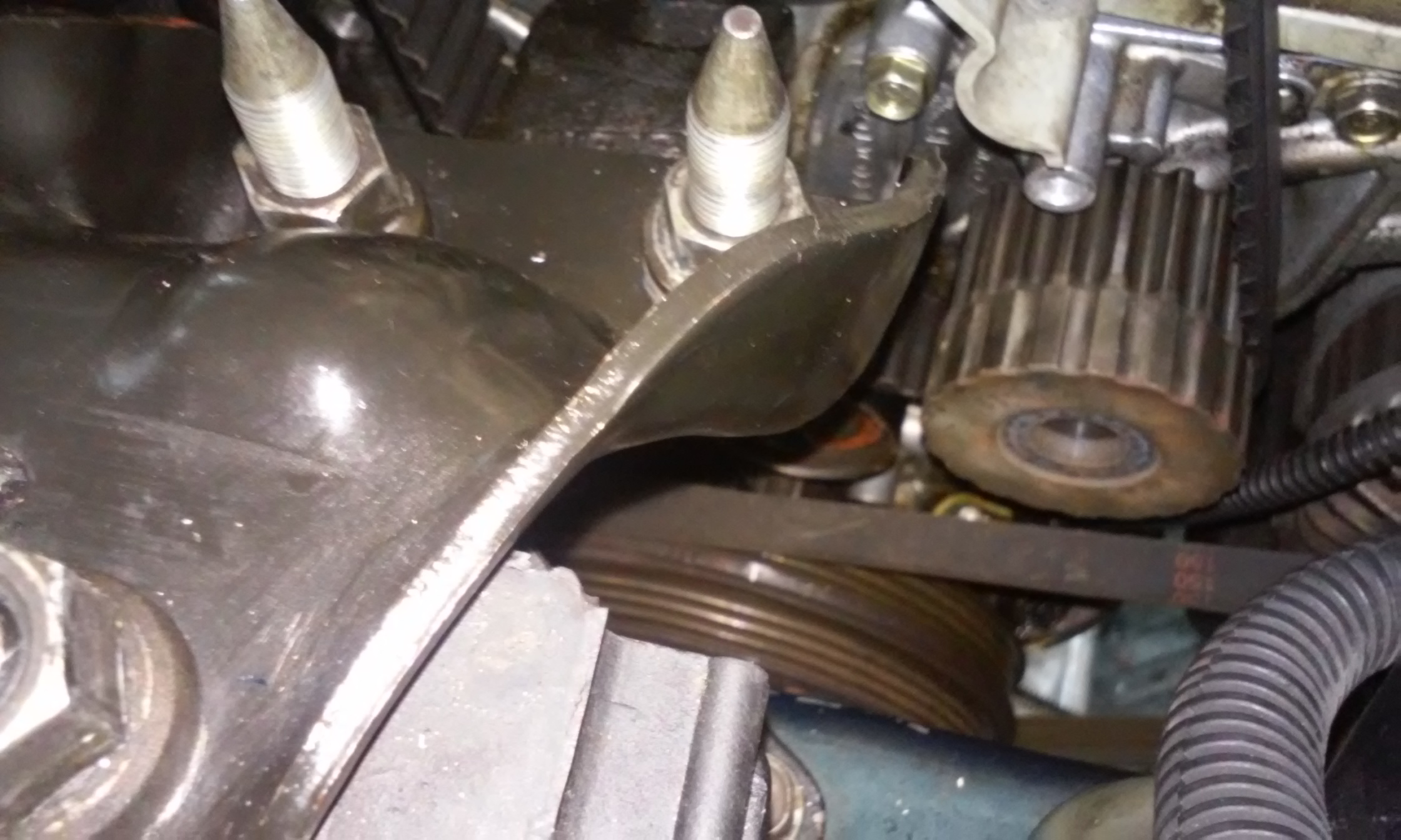

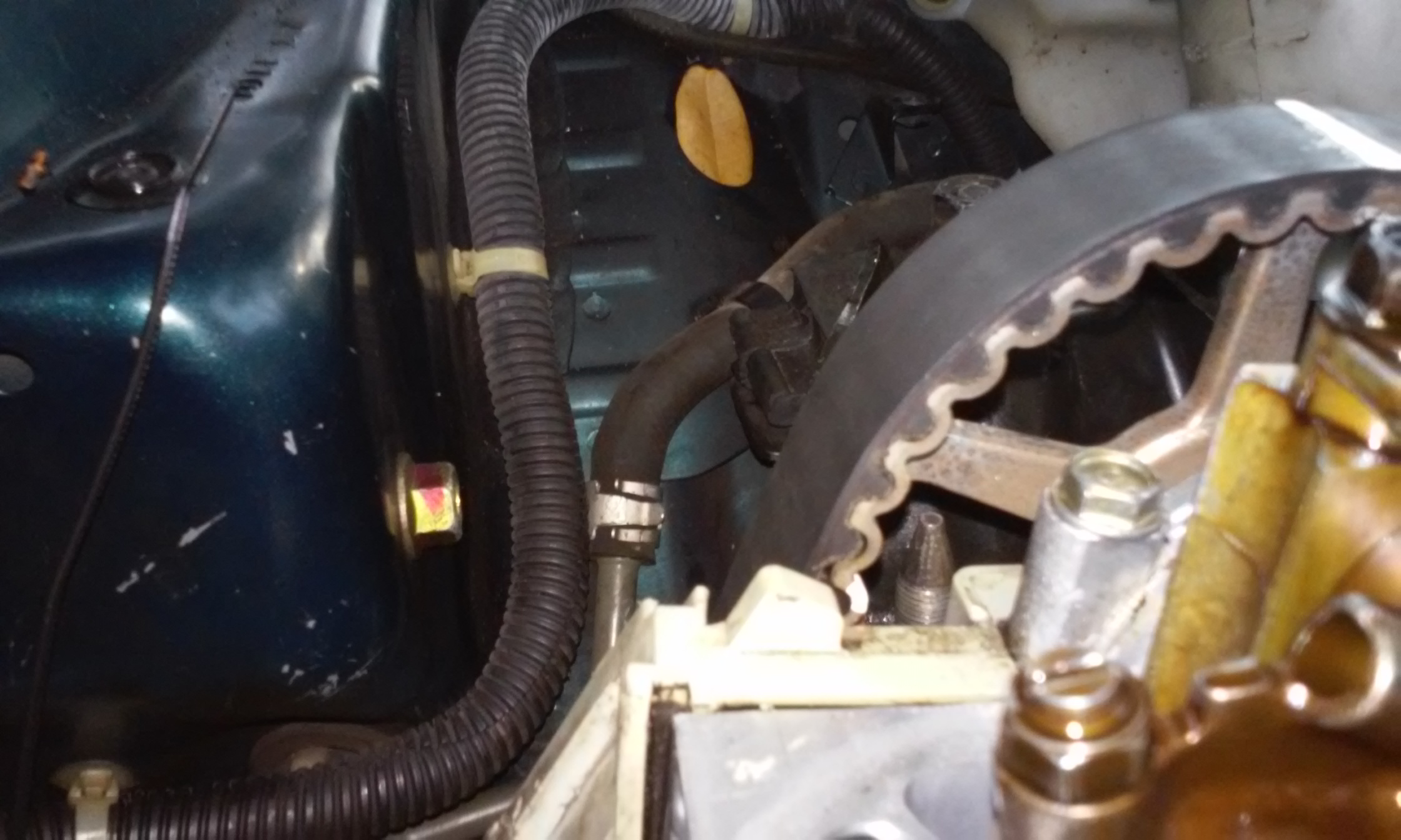

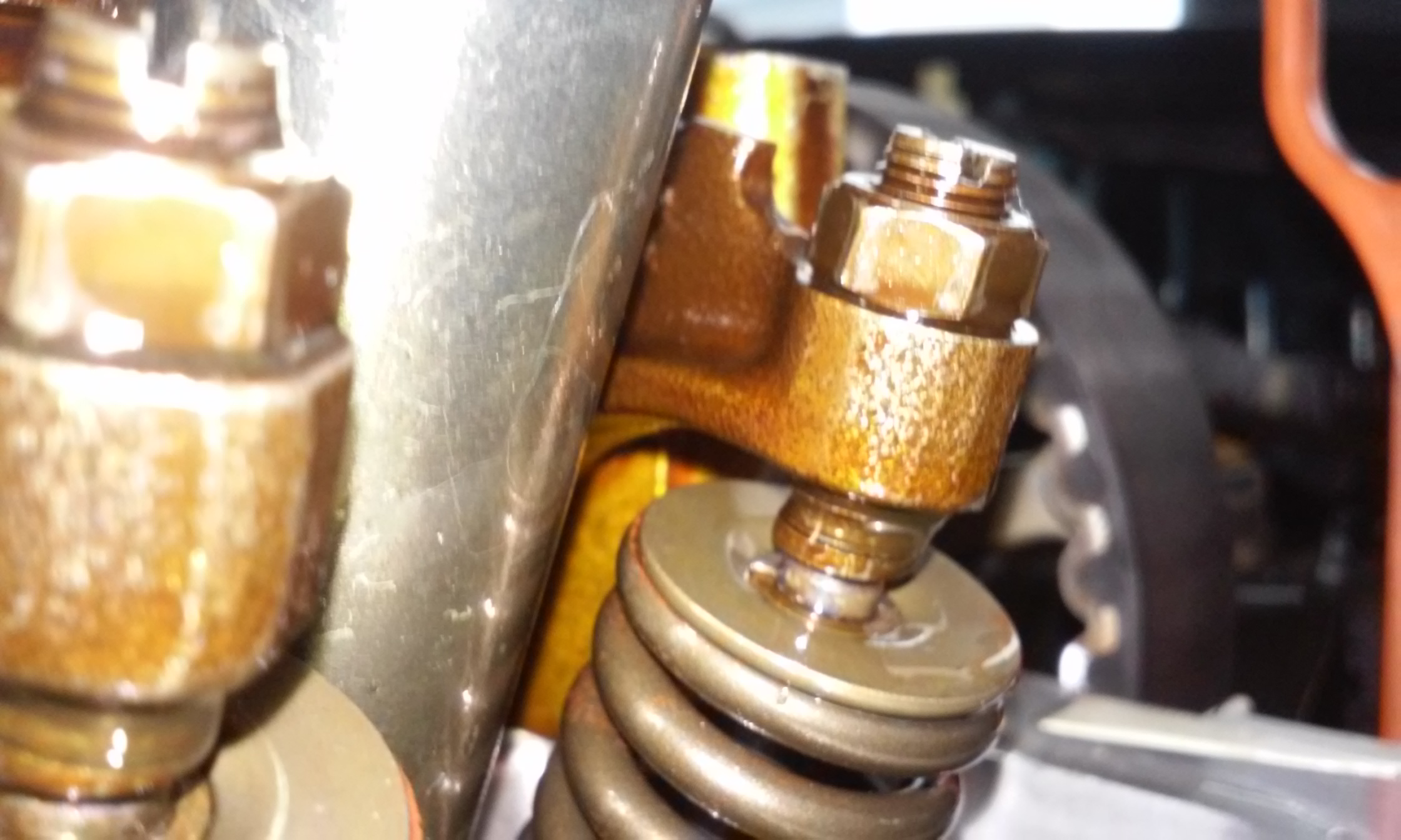

Well, looks like I spazzed it a again .. Timing marks are fine (see pics).
Retensioned belt, started engine and ran for 5 minutes. No CEL, no engine noise, timing seems good.
BUT
Burning oil near bottom of head and behind exhaust manifold (see pic) which looks new (smoke doesn't wain and gets worse when revved).
Large bubbles in radiator/coolant after operating temp reached. **I did not run engine long enough to burp coolant during prior test runs**
Didn't want to run it any longer than 5 minutes today so, still not properly burped... bubbles made me nervous.
My guess is head gasket is still leaking.

i think you are being a bit paranoid at this point in time,
if the engine is running fine i would drive the car, at least take it around the block and keep a close eye on the temp guage, if it gets past 3/4mark shut it off,
the best way to burp the system is to drive it, and give it a few blasts of fast acceleration/high rpms
It takes a while to get all the spilled fluids baked/burned off.
The bubbles IS the burping. The trapped air has to get out of the system somewhere.
I let them run until the fans cycle a few times for the burping process. Then button it up and go run the car up the highway.
Do what mikey said.
