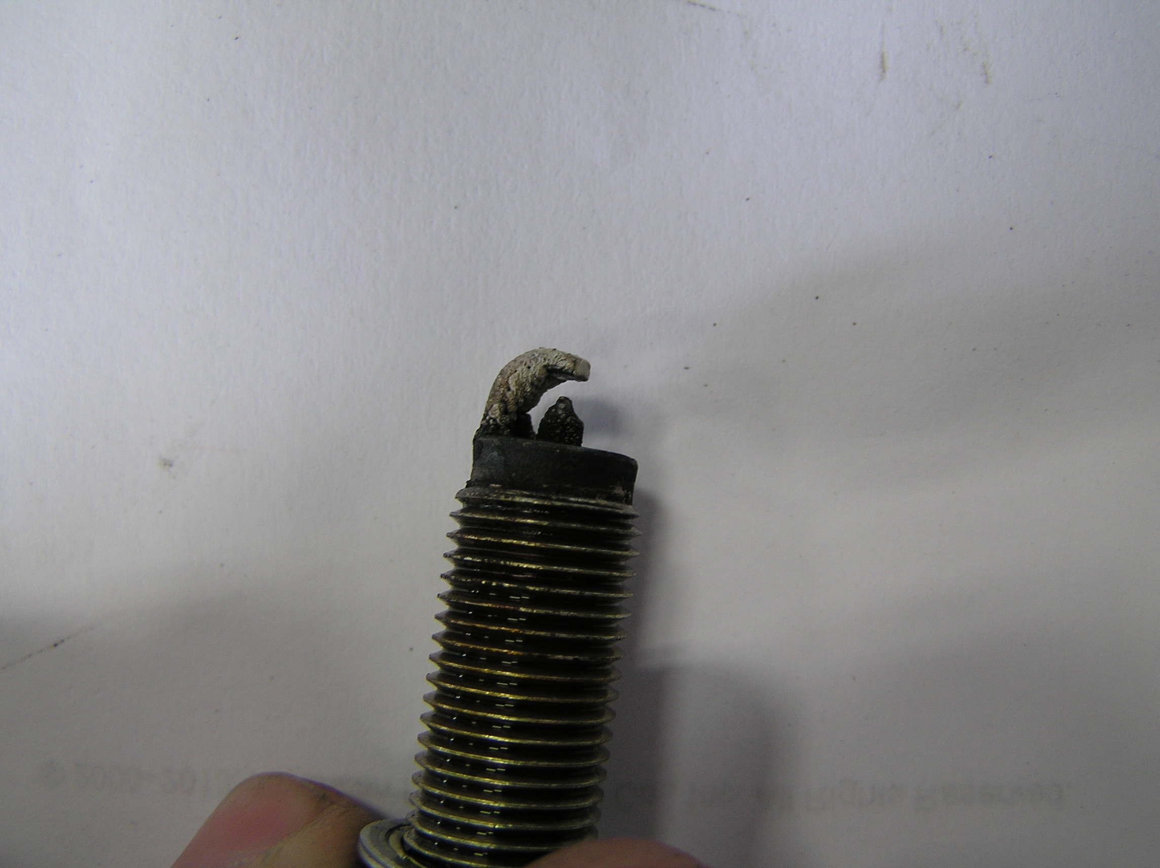

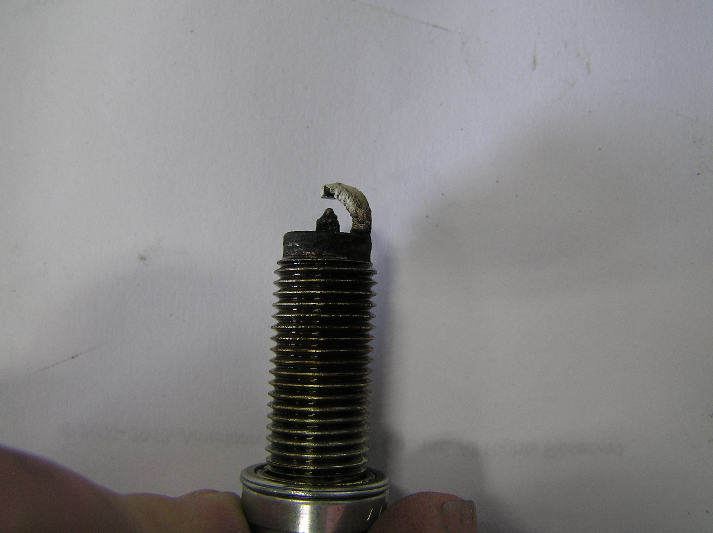

There are ash deposits on at least 2-3 plugs if not all, I can't recall correctly

If it's not leaking out, then it's either "leaking in" or burning it.
A working cat can hide a LOT of smoke.
Ash buildup on the plugs is a sign.
A quart in 120 miles----I'd almost expect wet and dark plugs.
