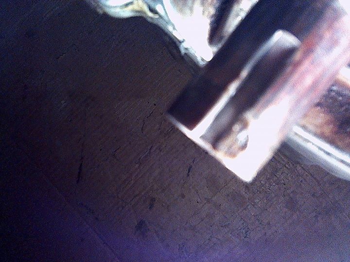

Yeah the end of the keyway chipped off, but not that bad and then farther in where the timing gear sits it is indented a bit. Very tight budget, there is no way I can afford a new crank. Filled in the indentation very carefully with a metal gap filler specifically designed for shaft repair (Loctite 660 quick metal retaining compound), set the balancer key also with the filler, and also replaced the chipped end of the keyway after the key was set. I let it all harden before I put the harmonic balancer on. The car ran great, It felt like a great success until I realize I basically cemented all that in there without the guide plate behind it. I did do my best to install it in a way that wouldn't get everything stuck real good so hopefully It will not be too hard to uninstall. For all I know it might have been running a tiny bit out of time, but I don't know how noticeable that would be and I did not hear any unusual noises. I would say I put about 20 miles on her before I realized the inevitable disaster. yeah I was pretty pissed off some a hole would be so careless install without key. So about the timing belt gear.. the original gear's key looks damaged, there is play when I put it on the crank and the key looks a bit too thin. I ordered the wrong replacement and got one for 88-95 civic which is just the teeth and nothing to prevent travel from each side unlike the one I took out of the car. I seen a diagram for either my d16y8 with a different configuration or a d16y7 that showed the older gear with guide plates on each side and I was hoping someone could tell me if that would be ok to do. I mean I guess I would be resorting to an older timing gear configuration for this engine on a new one and that seems a little risky. If I cant get a for sure answer im just going to use the original gear again with the filler and keep the old one as a paper weight because its shiny and new. I also want to do this because it would mean next time probably wont be such a pain to get the gear because I wont have to put as much or any filler in there.

Got everything off the crank last night and took your advice about getting a new timing belt gear. The correct one for my engine. I realized if used the older gear my crank position sensor would have nothing to read. I am guessing the older civics don't have those or they are located elsewhere. Here is a pic of the damaged crankshaft.
Again I cant get a new crankshaft so I have to make this work haha. Although it sucks I had to do all this again because I forgot the guide plate, I am glad I got to see how the Loctite 660 quickmetal was holding up. I was very satisfied and have no doubt this will hold up until my next change or beyond. The car ran great when I first did this and I am conifident it will again. If it does fail later on it would just be the harmonic balancer, I am not worried about the timing belt gear. Thanks for the advice, much appreciated.
