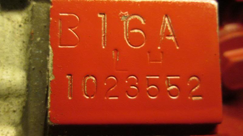

The stamping on the block reads B16A, below it is "LH" and below the number 1023552, the question the guy at the parts store had was weather it is a A2 or A3.
I'm not any sort of expert on swaps here.
I deal with mostly stock stuff.
But you need to figure out where all your major parts came from!
You might take a wire brush and some rust buster and see if there is a number after the A in the engine code.
Wiki the engine code to see what it came out of: http://en.wikipedia.org/wiki/Honda_B_engine
OBD2 computer in that car? Seriously doubt it, but it's possible.
I'd guess there may be a boatload of codes for equipment that is nonexistent in the car, if it is an OBD2 unit..
Does the check engine light even work at all?
Does it have codes stored?
What is the part number on the PCM? Maybe we can see what car that actually came out of.
Honda is very specific about stamping their engines....if you don't see a '1' or '2' or '3' after the B16A then it's probably a B16A
Read the link ezone posted to wiki B series engines
http://asia.vtec.net/topics/enginecode.html
It sounds to me like you could spend a ton of time and money working on what is probably a half cooked engine from somebody running the hell out of it with a turbo on it. They probably sold the turbo to somebody and you got what was left. Sorry to tell you that. On the bright side you're no stranger to turning wrenches and Honda's are super easy to work on. You would probably be so much further ahead of the game just to swap another engine in. I know, doesn't sound like the easy solution but you can get good used engines for $500 and up. For someone who knows what they are doing....maybe 2 - 7 days to install it depending on how many new gaskets you want to put in the engine before you install it. Then you'll have a headache free, reliable peace of mind car for your daughter.

Thank you for the responses. So far, it seems to be running pretty good, and the oil leak from the valve cover/oil distribution block seems to have abated.
Here are a couple pics. Engine stamping-

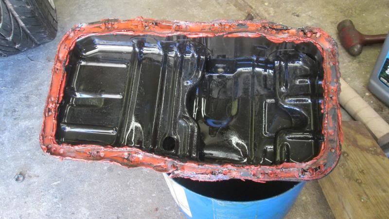

What the oil pan looked like when pulled-

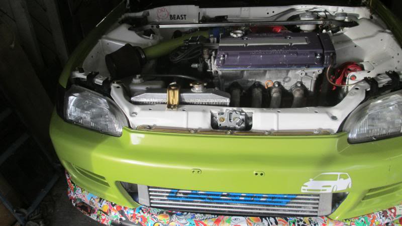

The nose of the beast, yes, it is not exactly to my taste but my daughter loves it-

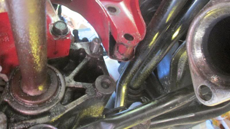

Broken mount bolt after I got the stub mostly out-

wow... am just imagining your face as she says - this is the green car i want!
g'lucky, these "hybrids" are the though ones to handle... no tax savings with these either...

The orange painted engine code pad, the important broken bolts ("I don't think anyone will notice!") and the orange Cheez-Whizz all over that oil pan....

I'm digging the Hello Kitty sticker on the firewall too.
