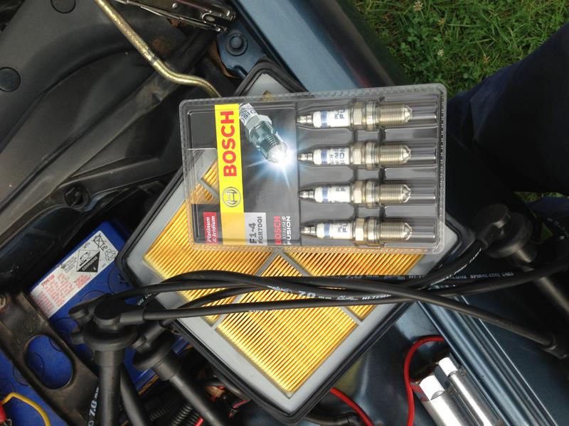

I used Bosch plugs the local store looked in there book and told me these were the top of the range plugs they had for my car.

Check the gaps in the plugs also, even though most of the upper range plugs come pre-gapped, a small jolt while they are still in the box or during installation could throw it off. Just speaking from experience I have had with my truck.
Top range means "highest profit margin".
Throw those away and buy the correct NGK plugs.
Not kidding one bit.
Botch plugs are the first things to go when looking for driveability problems.
