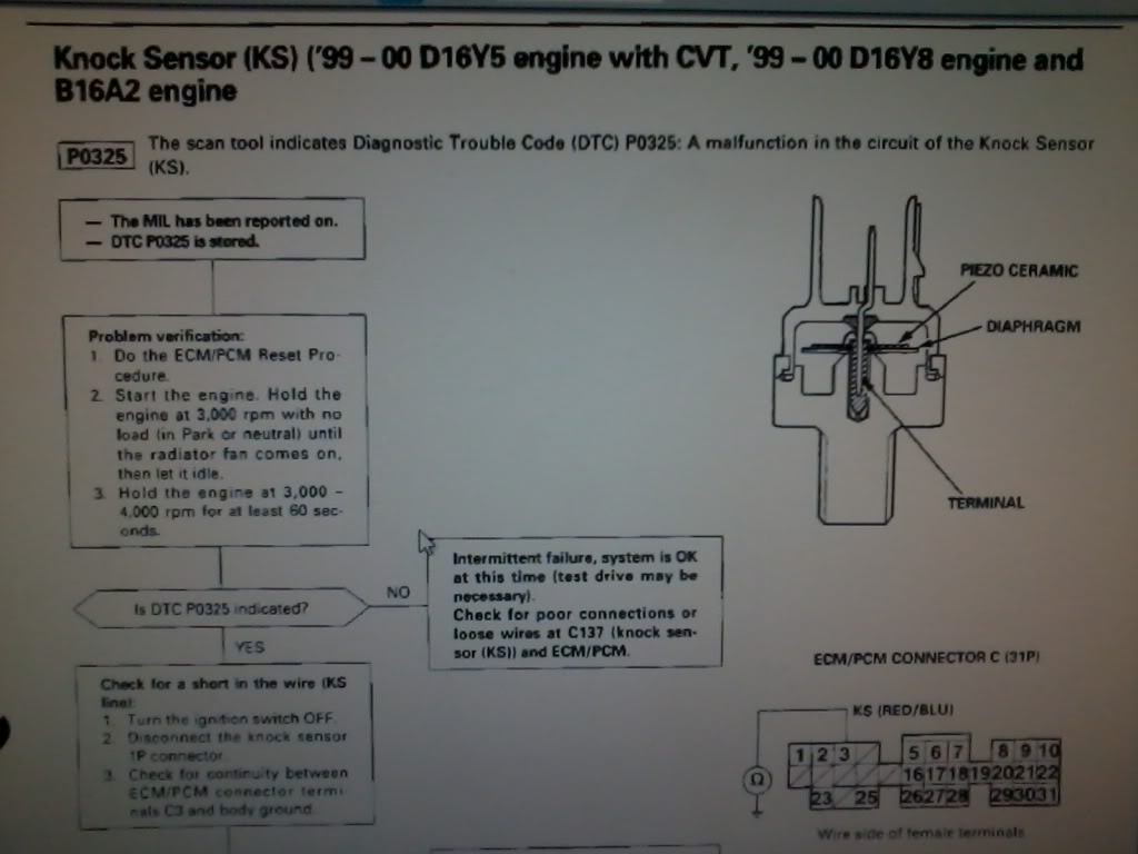

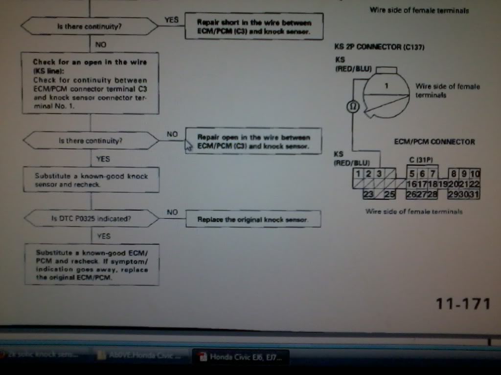

chk engine light keeps coming back on with knock sensor code. What can I do??
