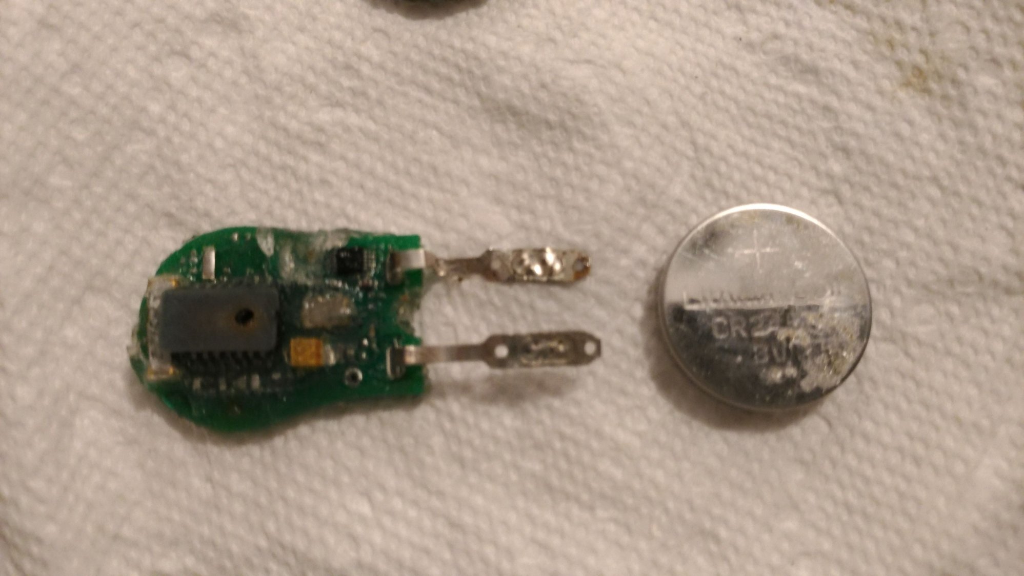

you can change the batteries on these sensors.
I had few goo..
u need to buy a batteru from battery america with solder tabs.
cr4050 with solder tabs.. u need to send them a picture so they will weld to the battery to the right connection.
Tpms comes appart,
I will have some picture when I do the next one.
basicly u need to cut the jelly clear inside carefully clean it up, sotter the battery in, and put it in the assembly with some clear silicone.. make sure the ends u use super glue /..
it works, its cheap, u can do all wheels for under 20-30 dollars.
original battery taken apart
original battery shown.. u need to soother the new batteru with tabs directly to the pcb connection.. they come thru out of the green stuff..

I will post more detailed instruction the next time when I do this..
I wasnt trying to make a DIY , but I figured you guys dont like paying 200 dollars every 6 years to tpms sensors, that all you have to do is switch a new coin battery
