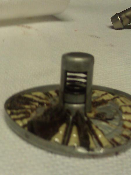

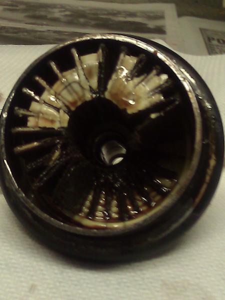

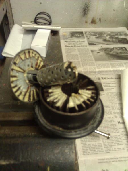

here are pics of the cut away of the auto trans filter from my 2007 EX coupe
40,000 miles on it of ( new york stop and go).
At 20,000 i drain and filled ( 3 QTS)
aftter this was changed, I drained and filled again -3QTS.
A bit of a pain in the *** to get to ,but not impossible and not really any specail tools needed- ( I did buy a cable operated hose clamp piers - which I had to use) .

What is the filter element made out of?
Is it a fine mesh screen, a paper element, a fabric element?

im not even sure its a real filter in a traditional sense. i stopped using it because it would never really have anything trapped inside. im doubtful it does anything at all.

Re: Auto trans filter CHANGED
sorry for the late response.
the filter is actually paper/carboard, glued on both ends.
the is a metal perf tube down the middle.
I did see a check valve as well built into it as well.
I cut it open with a copper pipe cutter so there is no "shrapnel" .

or it may be a bypass on a spring in case the filter is actually too restricive/clogged.

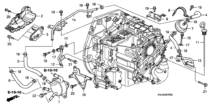

I have a 2006 EX Coupe with 70k miles and have never changed the tranny fluid yet. Yes, I now know that it is way overdue. I have read quite a few posts and plan on doing the 3x drain/refill technique. I have located the drain plug (bolt in right side of tranny case with ~3/8" square hole in it). But where in the heck is this filter hidden?
I have followed hose #5 to tube #14 but I can not see where the other end of tube #14 connects to hose #4 and filter #7 (see attachment). If the diagram showed where tube #13 connected to the case it would help but it doesn't.
Would someone mind helping me locate it? Thanks.

Drivers side rear of engine.
You may want to try a single drain and fill to start with in your case.

I took another, much closer look and found it; on the drivers side rear of engine as CraigW mentions. Thanks.
From underneath I can see it and reach the lower spring clamp. I can not imagine how I would be able to get to the bolt holding the filter and the upper spring clamp from underneath. Do I need to remove the air filter box and access it from the top?
For the $25 that the filter costs I would prefer to replace it while I am at it.

Manual says "remove the air cleaner assembly and intake air duct" as 1st step.

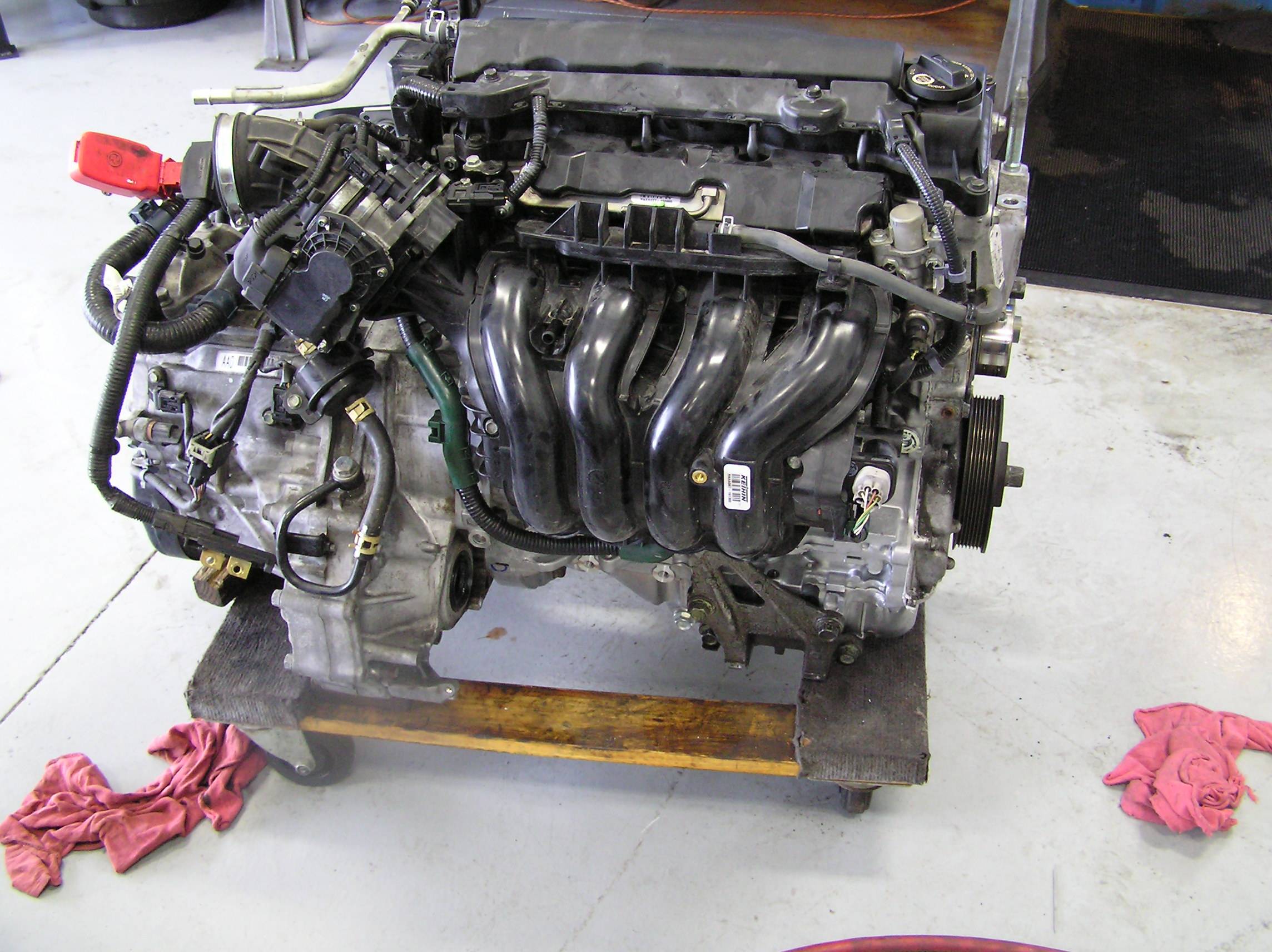

Old Jan 10, 2014
It's like hanging out there in front of God and everybody!
(......after the powertrain is on the ground)

There you go....pull engine/transmission, replace filter and re-install.

NOW it makes sense, thanks for the picture. I think I will just do the drain and refill this time around then buy the Service Manual if I decide to replace the filter later.
