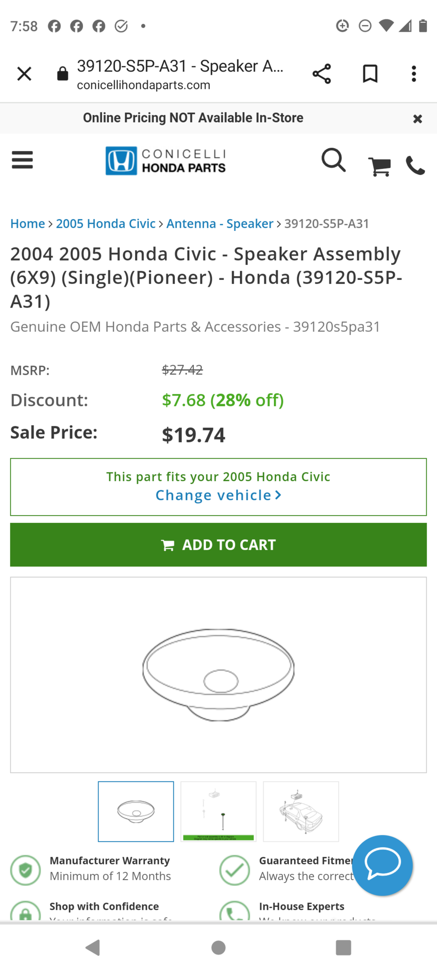

Can I be sure this fits
39120-S5P-A31.. that's the part number but it says it's 6"×9" and I'm pretty sure my two rear deck speakers are round..If possible I'm having a hard time finding aftermarket rear deck speaker kits that match from Amazon(,(I got a gift card for Christmas) Could someone who has patience or internet savvy lead me to 2
speakers that fit a 2005 Honda civic LX sedan from Amazon.

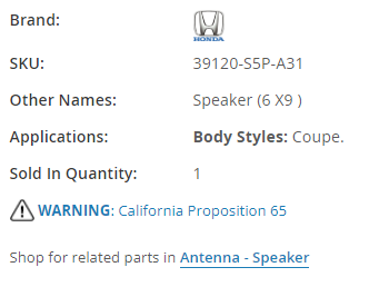

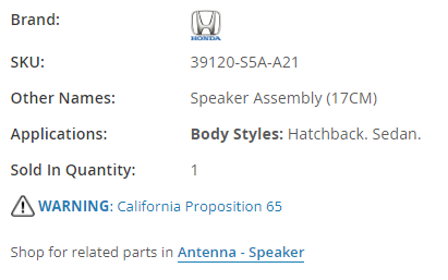

Coupes had the 6x9's, sedans had the 6.5's. There should be a bit that shows what body styles they apply to. I'm not sure if it shows it on mobile (I looked on desktop), but you should see this little tidbit on the 4th line in the description

I see, coupe. I only have mobile for Internet.
