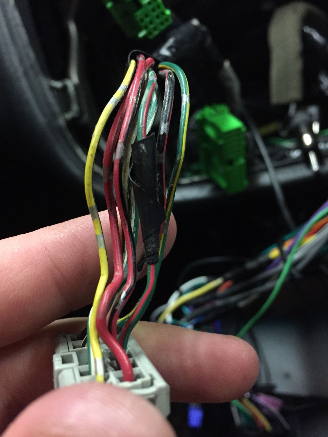

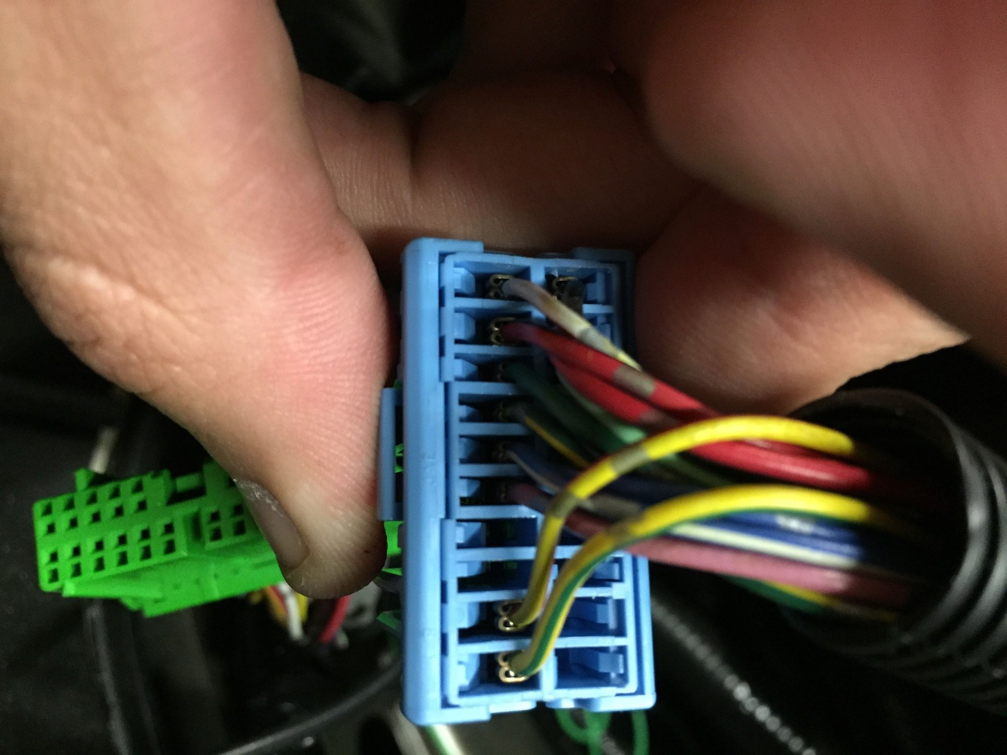

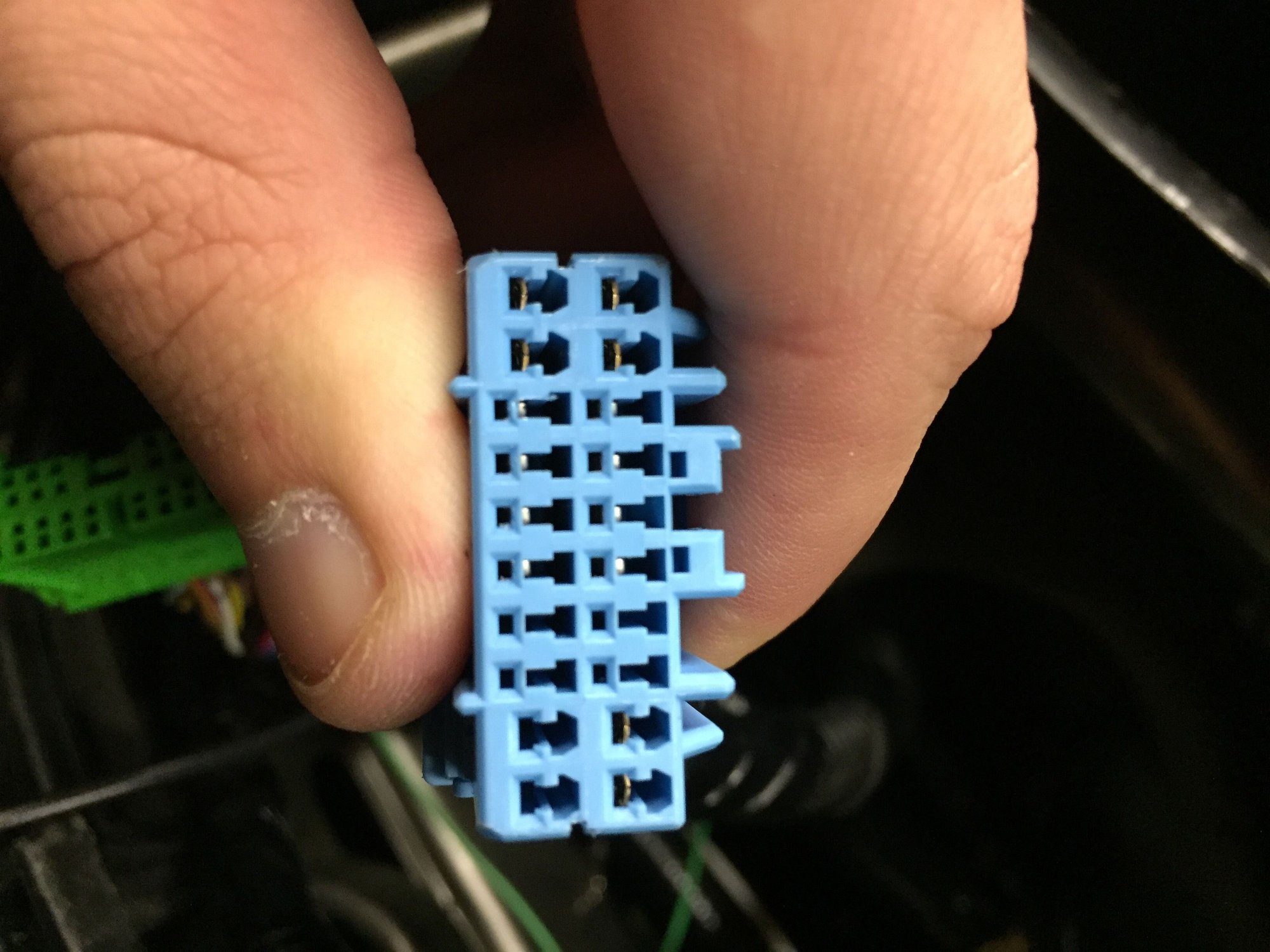

Was looking for some help with an issue I've come across when trying to install the pac swi-rc into my 2005 Honda Civic Lx. For 1998-2005 Honda Models, the instructions indicate that the white wire from the interface should connect to pin 3 (red/green) on the honda20 connector. But on my honda20 connector (blue) pin3 is empty. The only red/green wire I found was in a grey connector of which I'm pretty sure is not a honda20 connector that appears to be for the hazard lights. Not sure if I should scrap my plans for the install as I'm not sure how to proceed. Any feedback would be much appreciated.

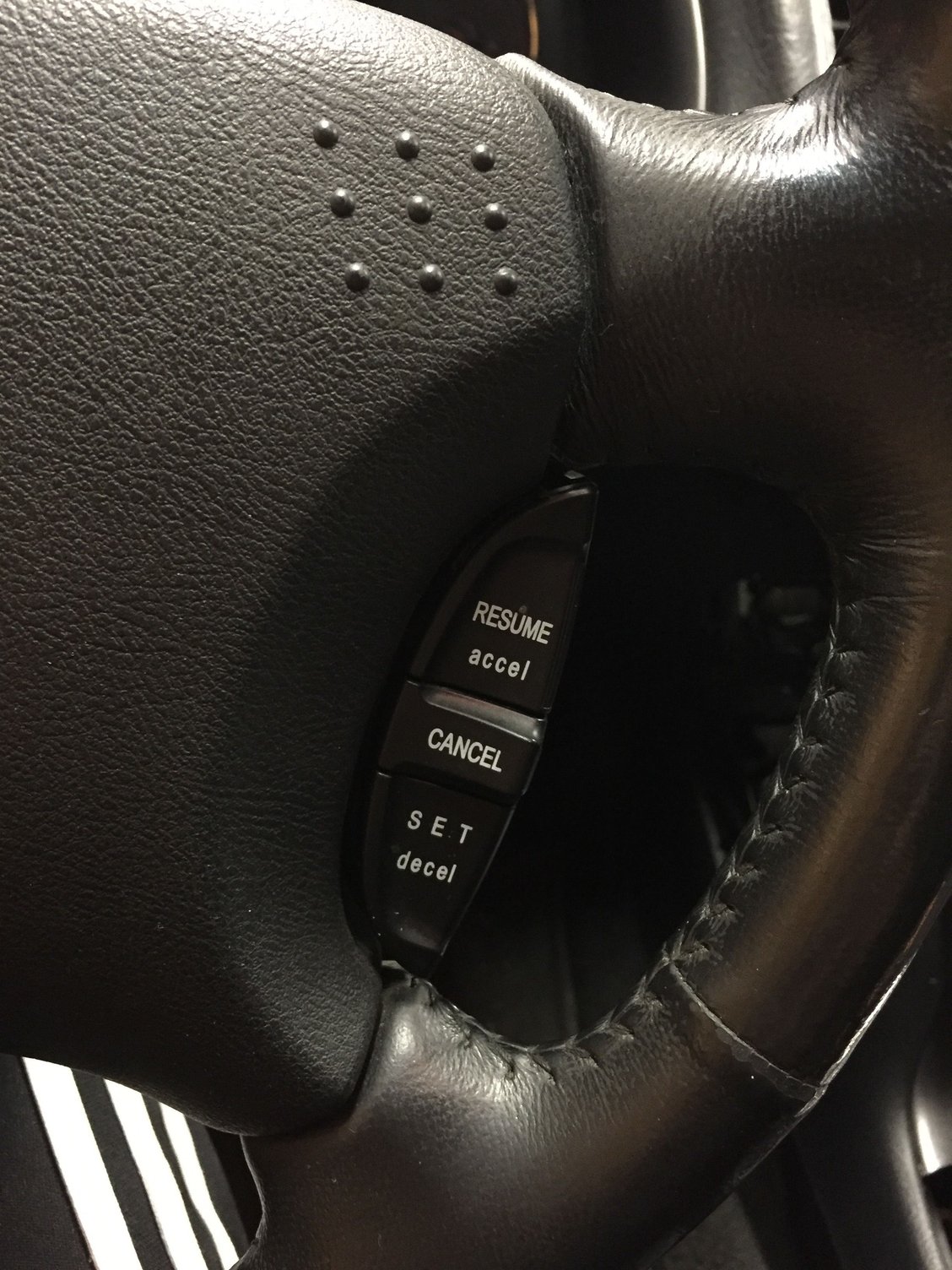

No mode button. Just resume, cancel and set as shown in the picture.

Oh. That install guide covers 2 different generations of Civic (part of 6th and all of 7th gen). Not that generations can't have the same setup. It also mentions a brown wire in slot 11 which you don't have.
I would contact them.
Trying to find out what Pin 3 is suppose to be but it seems to not be used.

Dude, those are for the cruise control lol. 7th gens don't have steering wheel controls for the radio. The SWI-RC is a steering wheel control module so.. it won't work.
