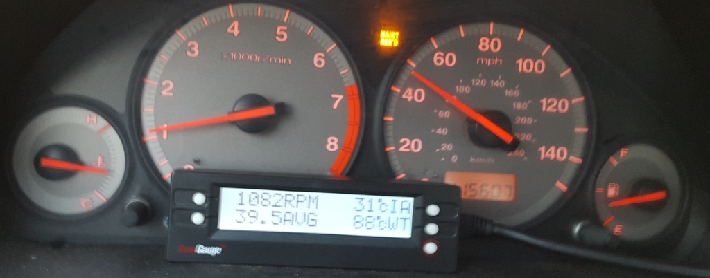

if you are turning the engine off with the key, i warn you that if it goes slightly too far, and you need to suddenly swerve the steering wheel will lock! Don't do it!
yes, it will cut off in gear, downhill, at 2500 RPM. Below that i do put in neutral. more than enough to get me these:
three times last week.

My usual is 32 to 35, but since temps are lower, no AC, and the traffic have not been bad, so 60-70 mpg on my morning commute = 39 mpg. Of course, lifting throttle or neutral when I can - driving is 90 % of all fuel economy
Ah, I don't brake in 96% of the corners, car can take them easily at posted limits
Small engine means momentum cars. Just keep it rolling and they delivers actually, this also helps driving fast
Stock 99,
Getting a scangauge or similar helps finding the best for mileage.
If I am entering a hwy, for example, I step in the gas - better reach steady state speed and keep it. Uses less gas than taking two days to reach posted limit (in small engines cars).

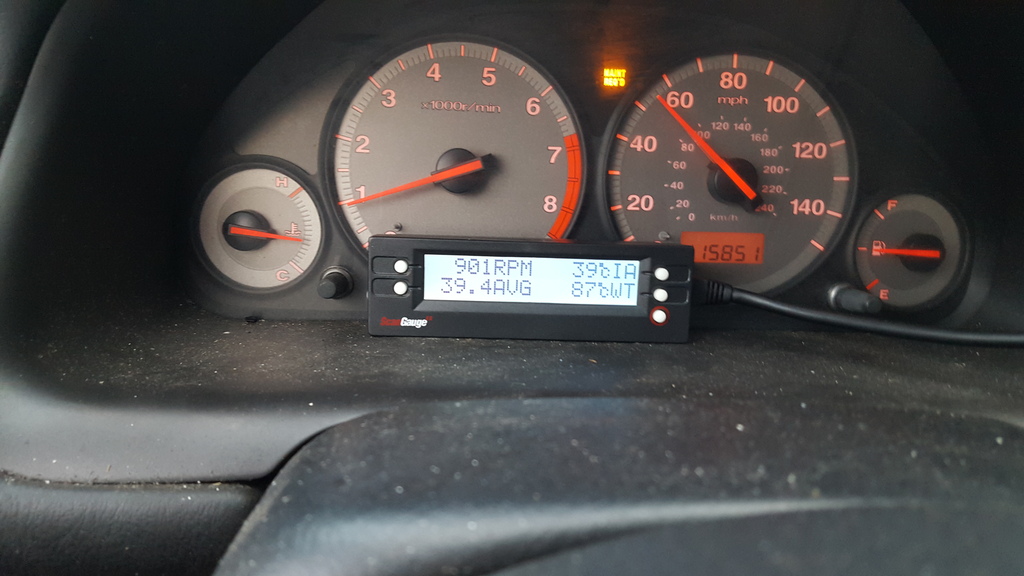

my brother thought he had only killed the engine. well, he simply went a tad too far. pretty expensive suspension damage, for the little savings he got...
i won't recommend...
no need to go that far... that could end up involving other people that does not have anything with your choice of doing it. See, i did it this morning again. it's plenty possible without doing engine kill. some less bright guy might read this and think it's OK... (that's the reason I can't agree, even if you can do it safely... Yeah, the kill switch will keep the wheel unlocked, so that's better than using the key.)
PS: Not cell phone, just a camera that can quickly turn on an shoot pics.
