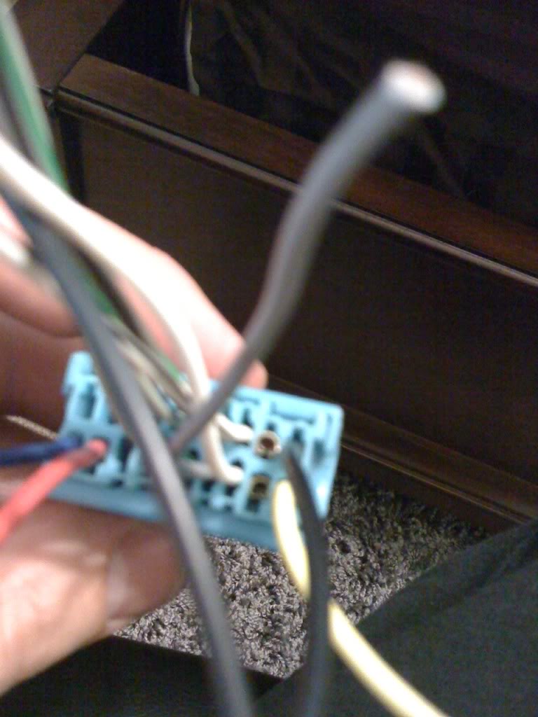

I think my harness is messed up lol I have been looking at it and it looks like the guy that had it before me pulled two wires out of it. I assume they were not required for his headunit and he didnt want them dangling back there.... idiot... but whatever I took a picture of it.
Is that orange/white wire from my headunits harness required for it to work?
In the manual it says connect to lighting switch terminal. If I dont connect it will it not light up or is that wire for dimming it and if I do not connect it will it not auto dim when I turn the headlights on?
I dont much care if the HU dims or not to be honest. I have no idea how to fix the harness nor do I want to go buy another one really...
Oh and my head unit harness doesnt have a blue wire for power antenna it only has a remote line. Do I take all three blues Remote( from harness ), Power Antenna, and Remote line from amp and crimp them all together? Will that work? Or what do I do with the power antenna line if not that?
Or do I just need to buy another harness.......

buying a new harness will save you some headache. You dont need to connect the orange wire unless your head unit has one on its harness. (my apline head unit doesnt dim when the headlights are on so it doesnt have an orange lead on its harness). I wouldnt crimp the remote wire with the power antenna cable. Just connect the remote cable to the one running to the amp and cap the power antenna wire with a wire nut or electrical tape.

The orange/white wire is for the dimmer, dont connect that because it could blow the lights in your dash. The radio will still light up if you dont connect this wire, but it wont dim with the rest of the interior lights when you turn the headlights on
You can crimp them all together, the remote wire doesnt really power anything, just sends a 12v signal for the amp/antenna to power on/rise *Edit* If you crimp all three together, the power antenna will be up any time the radio is on regardless of input. If you want to fix that you can wire in a switch to control the antenna.

Alright got a new harness and am just going to redo it. This one has all the wires it is suppose to have.
Still need a answer on the should I hook the all three of the blue wires connected?
Since my HU harness does not have a power antenna line it only has a remote line it seems to me like I would crimp the power antenna from the car harness the remote from HU harness and the remote line from the amp all together.
But seem people say to do that some dont....Any does it matter if the power antenna is always activated?

I would hook your amp remote wire to the ignition, and the power att to the hu remote turn on. Your headunit harness should have included a attn wire. Technically you could hook them all up together but you could blow a fuse or something. I don't know how much current is required for the attn, or amp turn on but it could overload it. You could also do hu remote turn on to amp (since that's probably what that wire is for) then hook your attn to the ignition so that it only sends power to the attn when the ignition is on.

Ya I called a local shop about my car and he said that he usually just hooks all three together.... IDK.... I am hoping it works just fine cause I just wired it all and got it in there today. And tomorrow I need to put all the pieces back in the car and wire the amp and sub....
