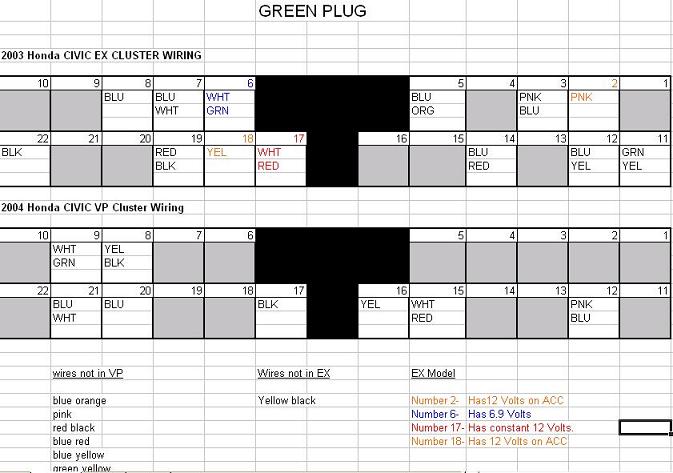

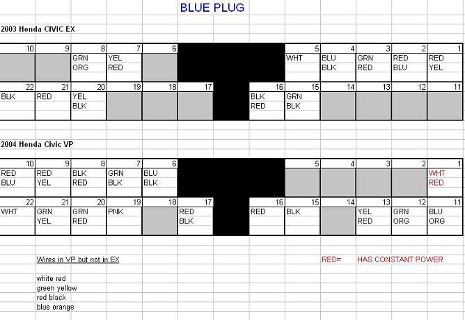

Here is the stuff you need for the em2 side of things.
There is another thing in this thread thats useful as well its like the next to last post
https://www.civicforums.com/forums/2...x-cluster.html
ID:	80330   Click image for larger version
