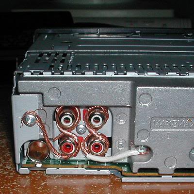

I have to agre with him also I am not talking about the EQ's own ground ou have to ground out the rcs outputs somtimes pioneers and chaper stuff do not have the best rca grounds. Wrap a peice of wire aroudn them and ground it. If not than just take the EQ out. Here is a pic of what I am talking about.

Thanks for the pic. I'll give it a shot.
