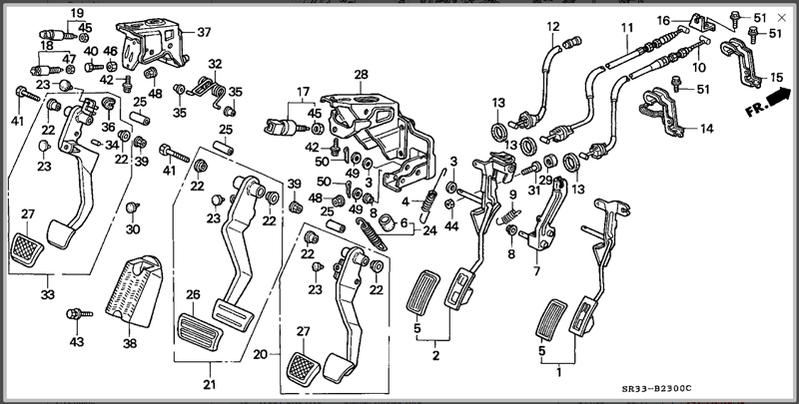

Re: Stupid Brake Lights
It's an auto. I am guessing part 23??
Old May 31, 2015
That's the one I'd pick.
