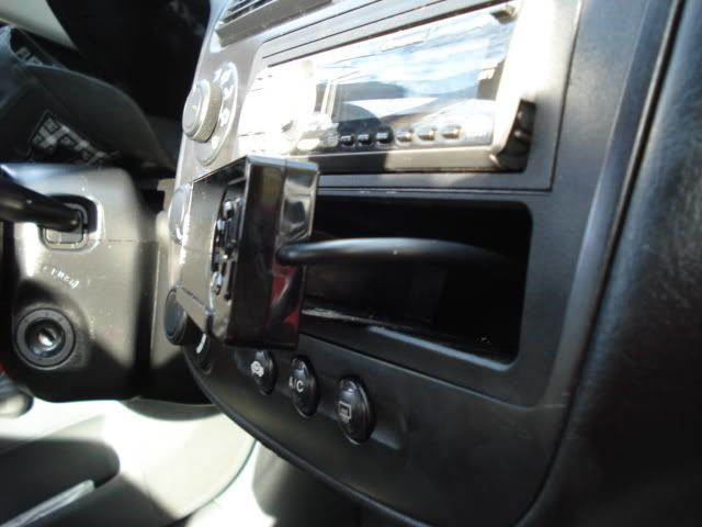

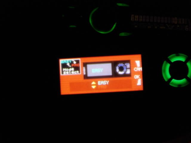

Hey sorry about not doing the wire-up but after I did it all the pics were blured and could not see anything that close up but heres a menu set-up on a positive note

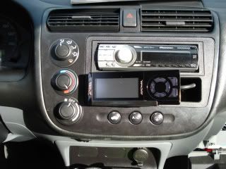

After installing the unit

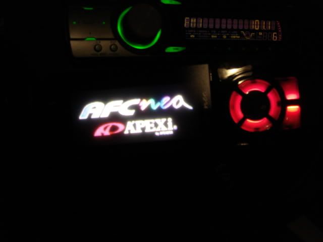

turn the key to the II position (DONT START) you should see the boot up screen

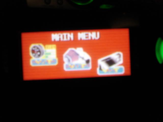

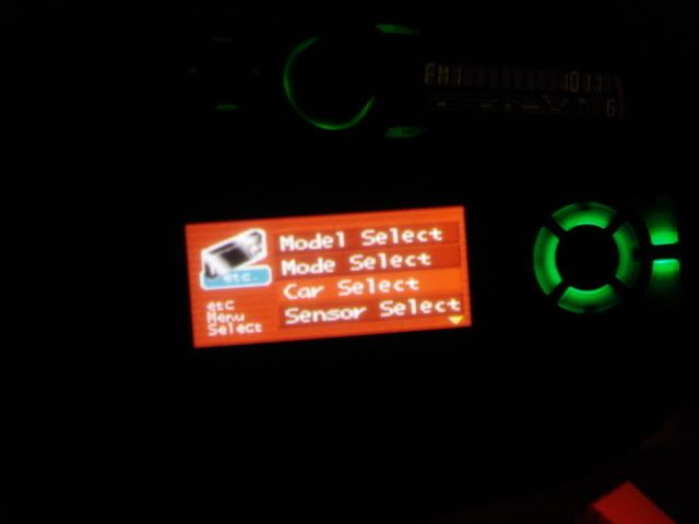

At the main menu select ECT. (third on the right)

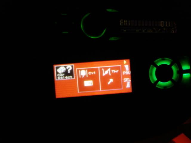

Select, CAR SELECT
Now change the # of cylinders to 4, the throttle position should be north east
Press the right arrow to calibrate the throttle.
Now select, MODE SELECT AND LEAVE IT AT EASY
PREV, MODEL SELECT

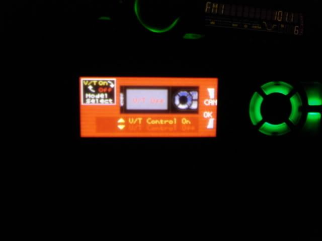

TURN VTEC CONTROLLER ON OR OFF IN MY CASE I LEAVE IT OFF SINCE I DONT HAVE IT
IF YOU TURN IT ON YOU SHOULD SEARCH WHAT RPM SUITS YOUR DRIVING BEST.

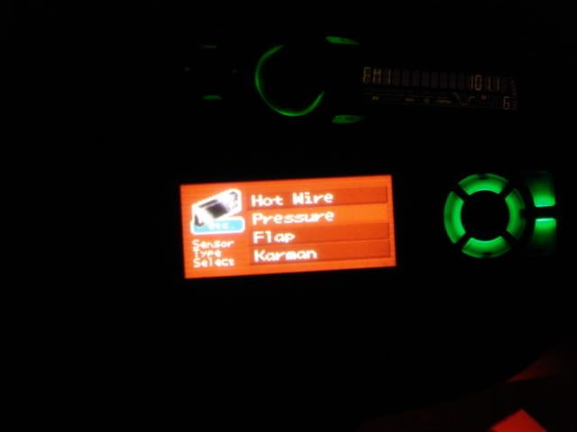

Now select, SENSOR SELECT
(01-05 civic) PRESSURE, IN 6 OUT 6

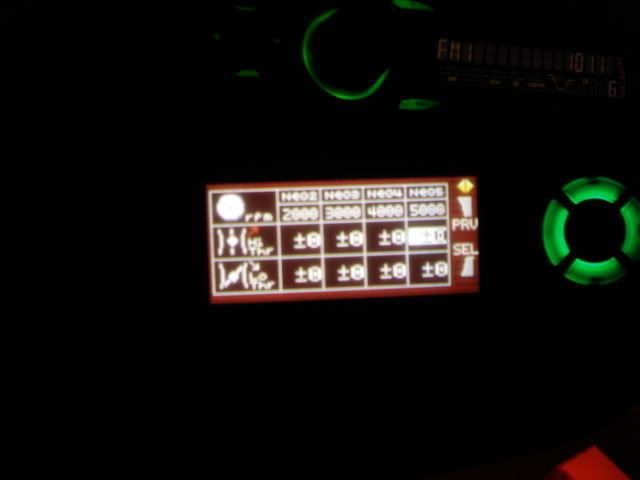

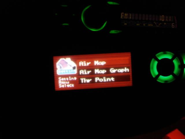

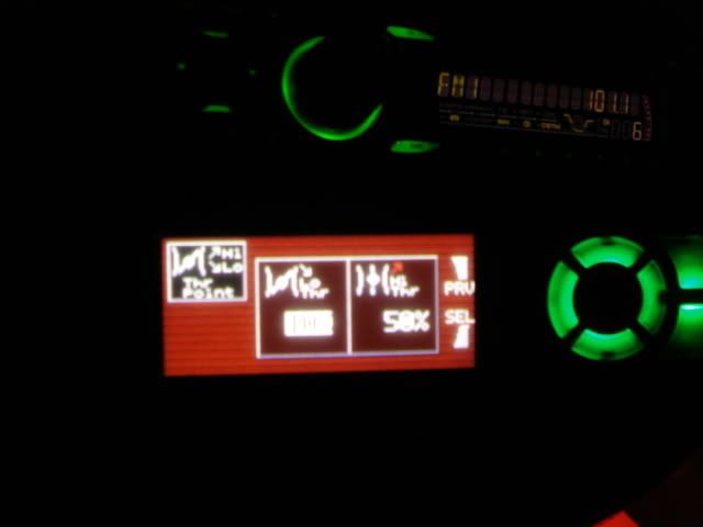

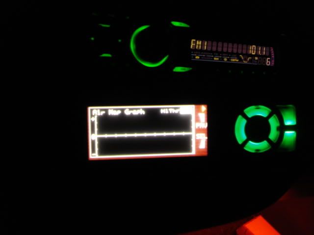

Now that thats done here is some pics of the air controller options ( DO NOT CHANGE UNLESS YOU WANT TO DO AN ENGINE SWAP FOR A STUPID REASON U CAN BLOW YOUR CAR UP, SHOULD BE PROFESSIONALLY TUNED )
throttle segragation
RPM range
and AIR map graph
After you have set every thing explained turn the car off and take key out.
NOW YOU CAN START THE CAR.

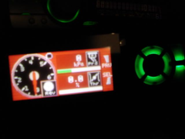

Select, DISPLAY
refer to your manual to select what sensor outputs and gauges you want to display after everythings selected it should look like some thing like this
CLICK HERE TO SEE THE NEO IN USE

What is the difference between Hot wire and Pressure???? I dont get any Kpa reading when i go to monitor with it on.... what gives?
Old Apr 6, 2008
twiztedD17A1's Avatar
Joined: Feb 2008
Posts: 151
From: Rockville, MD
Rep Power: 222
twiztedD17A1 is just really nicetwiztedD17A1 is just really nicetwiztedD17A1 is just really nicetwiztedD17A1 is just really nicetwiztedD17A1 is just really nice
Re: DIY: APEXI NEO menu walk-through
You hooked it up wrong, or the settings are wrong. What model/year civic do you have? Call Apex I the number is
APEX Integration, Inc.
1449 W Orange Grove Ave., Suite A
Orange, CA 92868
(714) 685-5700 Phone
(714) 685-5701 Fax
Business Hours
Monday - Friday
9:00a.m. - 6:00p.m. PST
They have one hell of a great customer support line.
Hot wire is for older cars it has a diode in the middle of the housing.
Pressure is what we have it senses how much air flow is coming into the air mani. by how much pressure is created by suction. -80=less pressure, -6=more pressure
