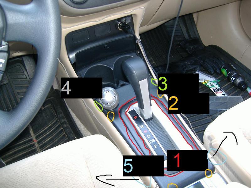

using the pic...
1. remove this trim piece (circled in red) with a flat head screwdriver
2. using the same screwdriver insert the screwdriver vertically and remove the big grey piece (the areas circled in yellow are areas where there is tabs and where to place the screwdriver.
3. unscrew the screws at the base of the cup holders and the top of the part you just removed in step 2
4. this part circled in Grey is one piece and will enable you to remove the radio without removing the whole center console.
5. use the screwdriver to pry the area in aqua away horizontally and once lose use the 2 parts to pull the whole part in step 4 away from the dash. you'll hear a crack but its nothing to worry about. it will all snap together when your done.
with that piece removed you can get to the 2 screws the other member posted pictures of. from there you can remove the radio. good luck
