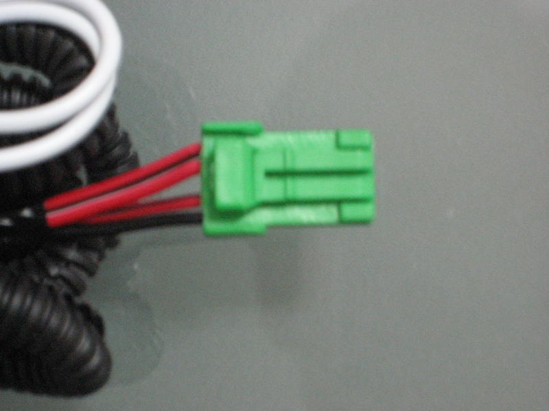

Here are some pictures of the Switch and harness that came with the fog lights. I would really like to use the factory Honda switch. What is my best approach?

that looks plug and play?

That switch is a NON OEM one. I would like to order the factory Honda switch and then wire it so it works with the NON factory fogs.

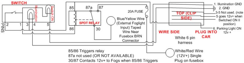

there is a relay somewhere in there right?
heres the diagram that i made for the rsx foglights.. just look at the switch..
i cannot take responsibility for any damage that is done by using my diagram. but hopefully it gets you in the right direction. the pins are numbered out of order on the diagram for the switch to keep the drawing tidy.. but when you connect them to the real switch, you should go in order.

the oe switch isnt what turns on the lights. It is just activating the relay. my guess would be with some wiring mentioned above, it will work fine. my aftermarket fogs actually came with an oe switch so i know it works
