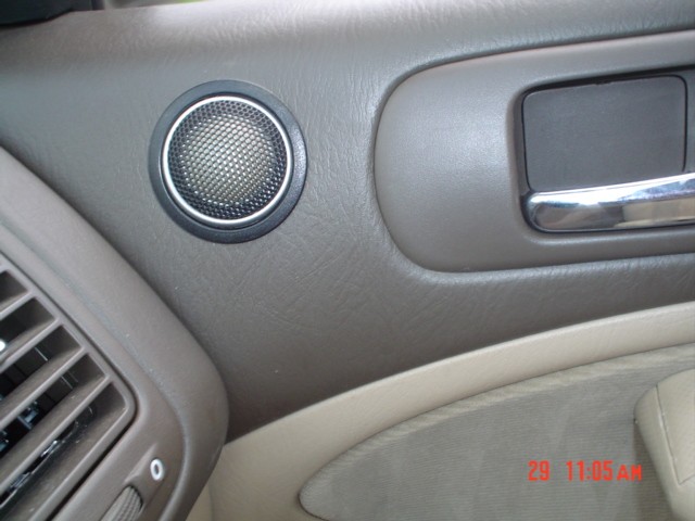

This is where I put mine. complete with swivel mounts
