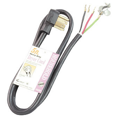

A replacement dryer cord is available at the hardware or appliance store, It will be about 3' in length. (make sure it matches your dryers outlet)
Also get an outlet that will be used for the compressor to plug into and a plastic box and cover that will house the outlet (all items in the electrical section) also ask for a clamp that will allow the wire to go into the box and be clamped.
You will need only 2 of the 3 wires available, 1 of the phases of 110v and the ground, 110v to the hot side of the outlet.
And ground wire will go to the neutral and the ground lugs of the outlet.
YOU MUST CUT AND ISOLATE THE OTHER UNUSED PHASE OF 110V WITH TAPE OR HEATSHRINK TUBING OR BOTH !!
first off what is the replacement dryer cord for?
now when I get a outlet, am I getting one that looks like a normal outlet that the regular compressor plug will plug into, or an outlet that the dryer plug will plug into?

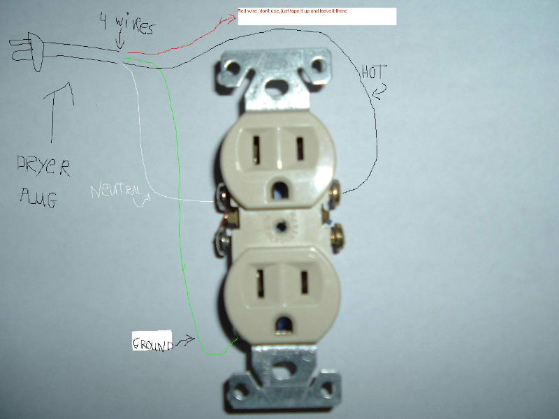

now after thinking about it, I think what you are having me do is take a dryer cord with the wires split at the end and run it to a outlet that is made for the compressor cord, am I correct? And when I am ready to use it, I will be disconnecting the regular dryer cord and plugging the new dryer code in connected to the oultet and then plugging in the compressor cord to that, am I correct?
please let me know more, thanks one of these plugs I need to wire into the outlet, correct

The attachment shown ^^ is the dryer cord I was talking about, Common item. (that one is a 4 wire and it would be even better) Separate neutral and ground.
The outlet and box would be for the compressor to plug into.
The clamp allows the wire to go into the box through an opening and also can be tightened down to hold/clamp the wire from moving in and out.
REMEMBER !!! What I said about the voltage difference, outlet has 220v you need 110v to run compressor.

if you have a dryer outlet in the garage near your compresser and want to use it, you can wire it up like this. (see pic that i attached).

The power coming in the house is really 110v .... to get 220v, they actually use 2 feeds of 110 at the same time.
110v wires have a + (black), - (white), and ground.
220v wires have a + (black), + (red), - (white), and ground.
So what they are saying is you take part of the 220 feed, which is actually 110. You can use the black and white ... or the red and white, its the same difference. Then the other one you just don't.
This is exactly what 05reverb was getting at in his picture.
The GFI might be over sensative. Its a common problem. I would try replacing that outlet. If that doesn't fix it .... Then I would add a 30 amp breaker to the box and run a dedicated line out to the compressor. Then have that outlet just for the compressor.

yeah as regular joe said, it would be best if you tried the GFCI's first because if you could fix that, it would be a better set-up than using the dryer outlet because you would have to unplug the dryer everytime you want to use the compresser
