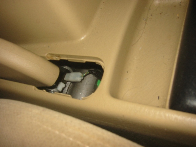

Well, it probably is not the problem with HU installation. It's the e-brake wire that became loose. Simply remove the cover near the brake handle(in front of the brake handle, a small U shape plastic), and move the connector a little bit so that sits secured. It should work out.
If you need picture, PM me.

I can say that I have that problem before, went to the dealer, they told me it's the connector's problem, not installation problem anyway. Don't do too much to it at this point, check the connector first before you put too much time and work in there.
