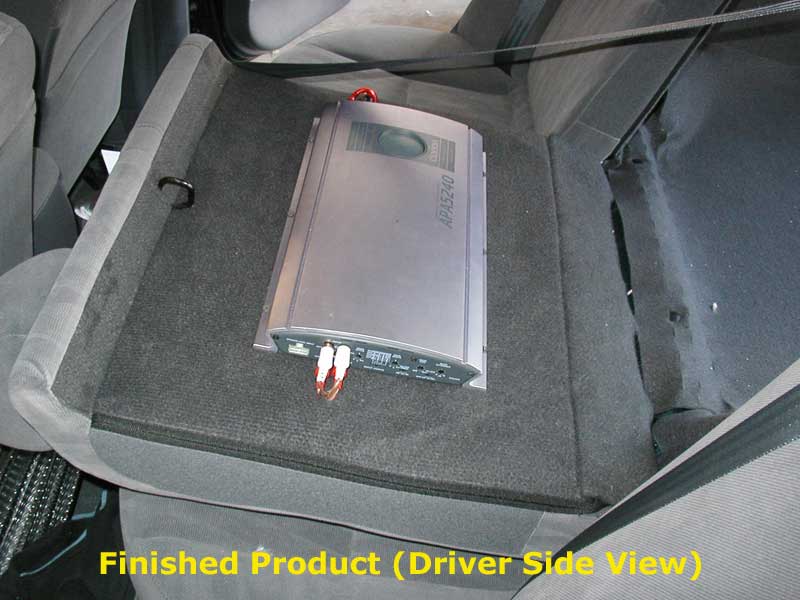

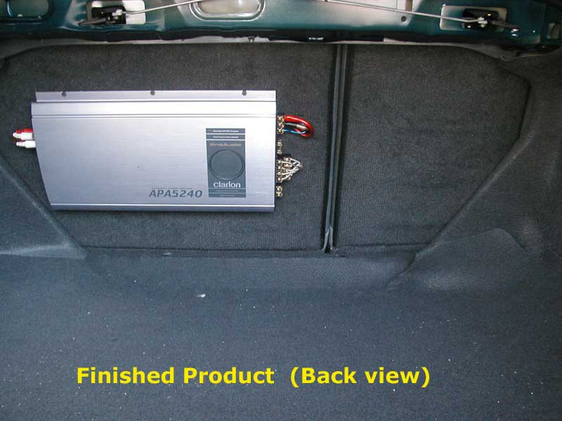

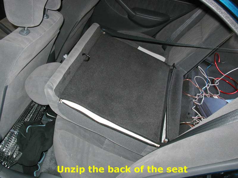

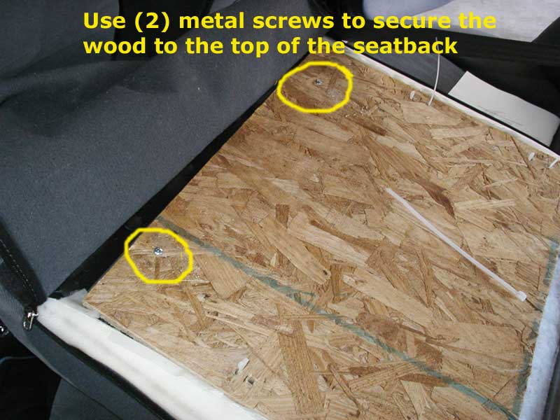

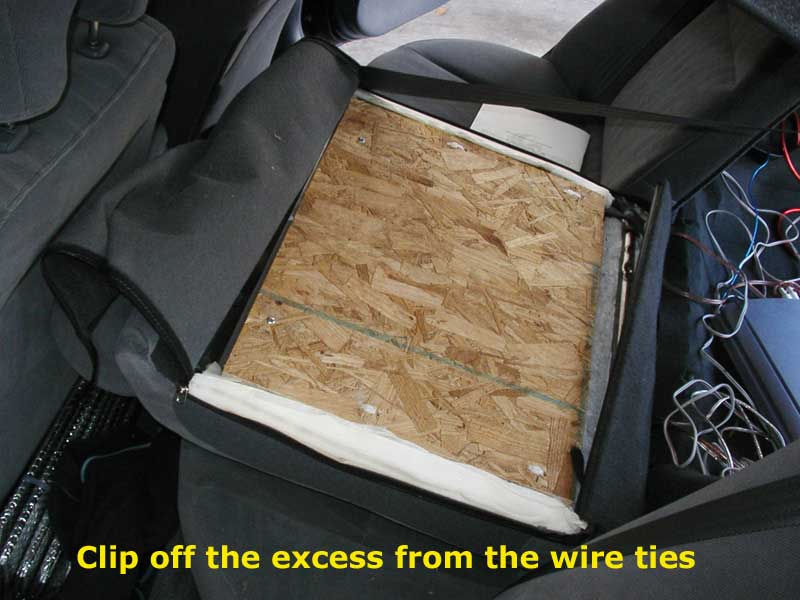

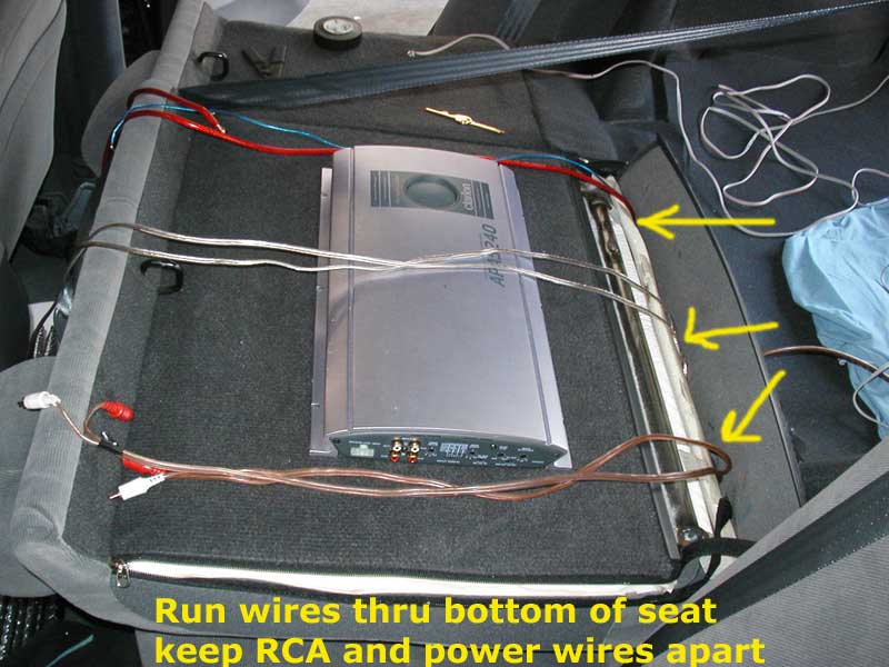

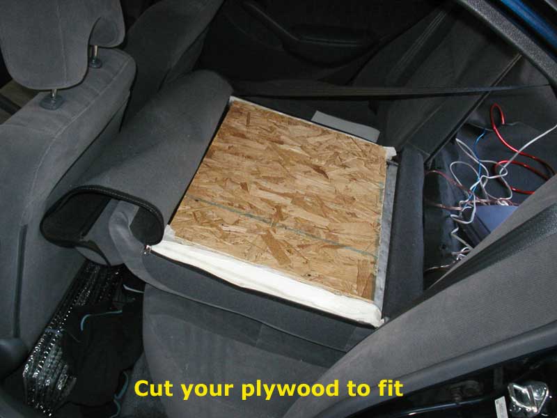

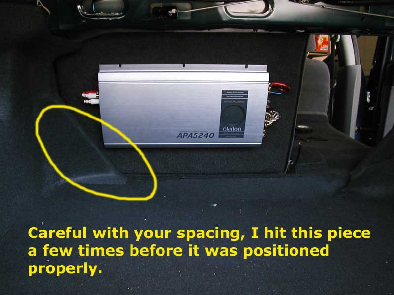

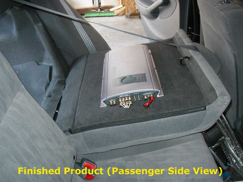

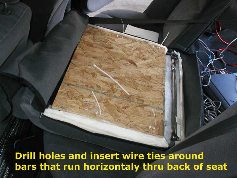

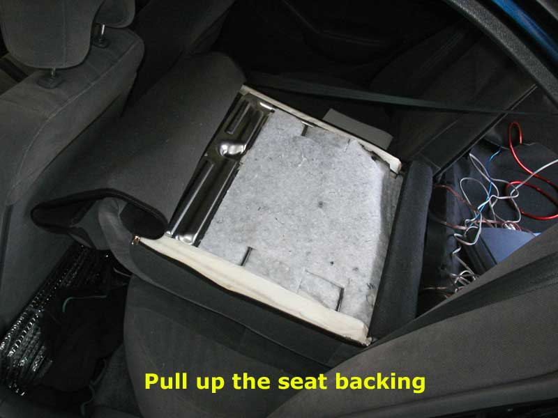

Just thought I would share the pics from the amplifier install I did in my 04 LX Sedan. Thanks to the other post in this forum explaining how to do this.
I installed an older 5 channel Clarion amp that drives the fronts, rears and a single 10" sub.
Some comments are included in each of the pics
Mike

very good way to reinforce that seat to the amp

Very nice. I did mine the same way on my coupe. Though my alpine amp has a cover that hides all of the wires. I will take some pictures of it as soon as I get a new camara.

oh forgot to ask you do you by any chance have the measurement of the board?

Nifty. Three questions:
1. Why not MDF?
2. How did you secure the lower edge of the wood to the seat? I noticed the screws near the top, but not down below.
3. Does the wood rattle at all against the metal in the seat?

lol its 1am and you know what i am going to go do the wire tie thingy since the board i have is a little loose. good call! !
EDIT: MDF is a little too thick to put back there. As it is this small board, which used to be larger and cover the spare , barely fits in there!

I would have posted lastnight but i fell asleep RIGHT after doing this!
I secured with 4 screws and 7 zip-ties. As for hiding the wiring I dont need to do that yet since I havent seen my amp in like 2 months. so I dont care if the wires are out like that.

Good idea with the twist ties, my piece of wood was able to move slightly. I didn't know what to do. I just took 2 mins and did the twist ties thing too. Now my piece of wood doesn't move at all.
