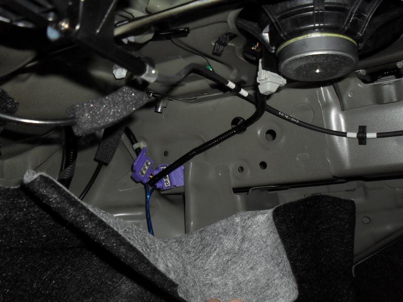

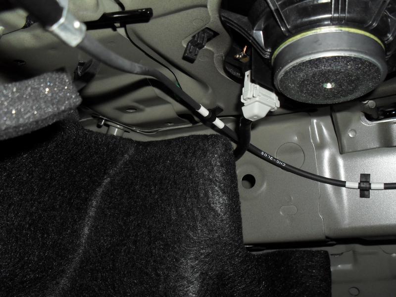

And this is what I mean by splicing behind the carpet:

Ahhhhh love Nero. Okay, now I see what you mean with behind the carpet. Yeah I guess if the 2014 doesn't have any filters, there's a good chance the 08 doesn't have any either. I'd just hate to go through everything to find out my sub isn't pushing anything lower than 35hz.
