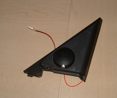

I'm looking for a great place to put my JL Audio tweeters in my 2003 sedan.
I came up with a great idea. It will require modding the car a little but I think it might be worth it in the end.
I'm looking to place the tweeter near the side mirror by making a hole in the plastic (how is this part called exactly?). They're just $5 CDN each to replace so it's no big deal to put some new plastic pieces back when I bring the car back (lease).
Has anyone tried this? How is the sound? I think this might be a pretty good location for great highs (although the tweeters won't be directed to my ear).
Since I have power mirrors, I will need to move the mirror connector a little. Has anyone done this? Any ideas?
Take a look at the picture, it will give you a good idea of what I want to do. The pic is from the passenger's side.

Ahhhhh.....That's the stock loction on US civics. IMO I think it is better to mount it as close to the mid-range as possible. It will be alot more off axis having the tweeter up that high. But if it's something you want to do go for it.

I would say just go buy the stock SAIL PANELS and put the tweeters in there. They should be cheap and they will look clean

Yeah, that's where I put mine. I just surface mounted them and they look great. I can hear a bit of separation between the tweeter and midrange, mainly while listening to jazz, but it's not too bad. I mounted them there for exactly the same reason you are considering it... I'm leasing too...
Also, you (and I) can't get the stock tweeter pods as Megahurtz suggested, because they only make pods for coupes.

I have power mirrors and the plug served as a problem. I had to take it all apart and hard wire it together so there would be no plug...or you can just unplug it. Its not like you have to have them. Here is a pic of mine....

Civic2uner... WOW! How did you to that? Is this a Honda part or what? The tweeter is pointed at you... I'd like more info on this.

That would be the USDM stock Ex sail panel. Why it required modifying to put a tweet there I do not know, as my aftermarket tweets went in mine just fine and I have power mirrors as well.

mine i had to modify cause they were too deep for the power mirror plug to fit.

Sedans have a mirror plug behind the sail panels, so you can't flush mount one. Surface mount is the only way, or cut up the door panel and put it there.
