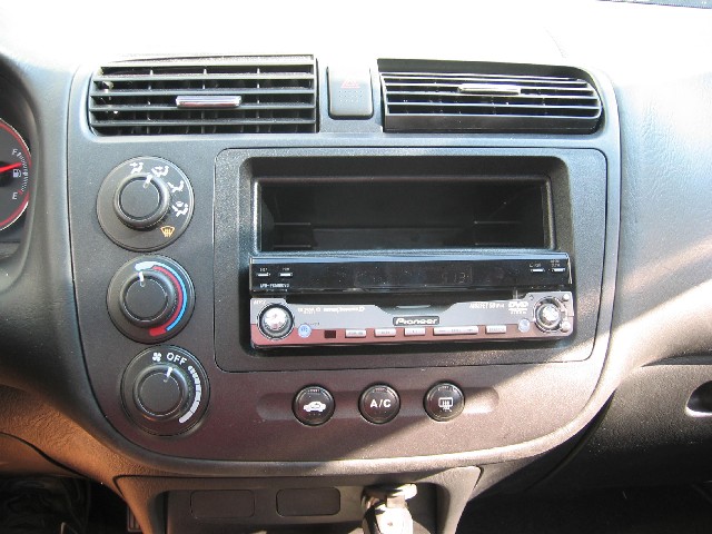

here are some pics

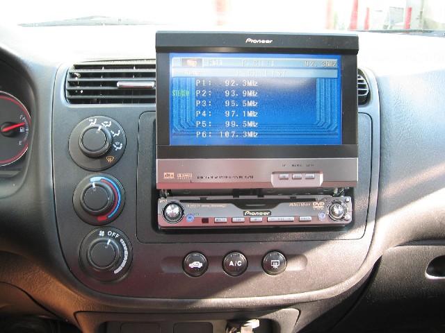

and...

i work at a local circuit city...u can get all those parts there...if you they don't have it in stock they can order it for you and usually get it within 3-5 business days.
met 99-7865: double din
met 88-00-9000: universal pocket
those are the city's model and brand number if you want to give that to them to make it easier to order.

i like it in the lower slot...doesn't look so high anymore...when screen comes out it's in a decent spot and far less visible from ppl outside of the car
