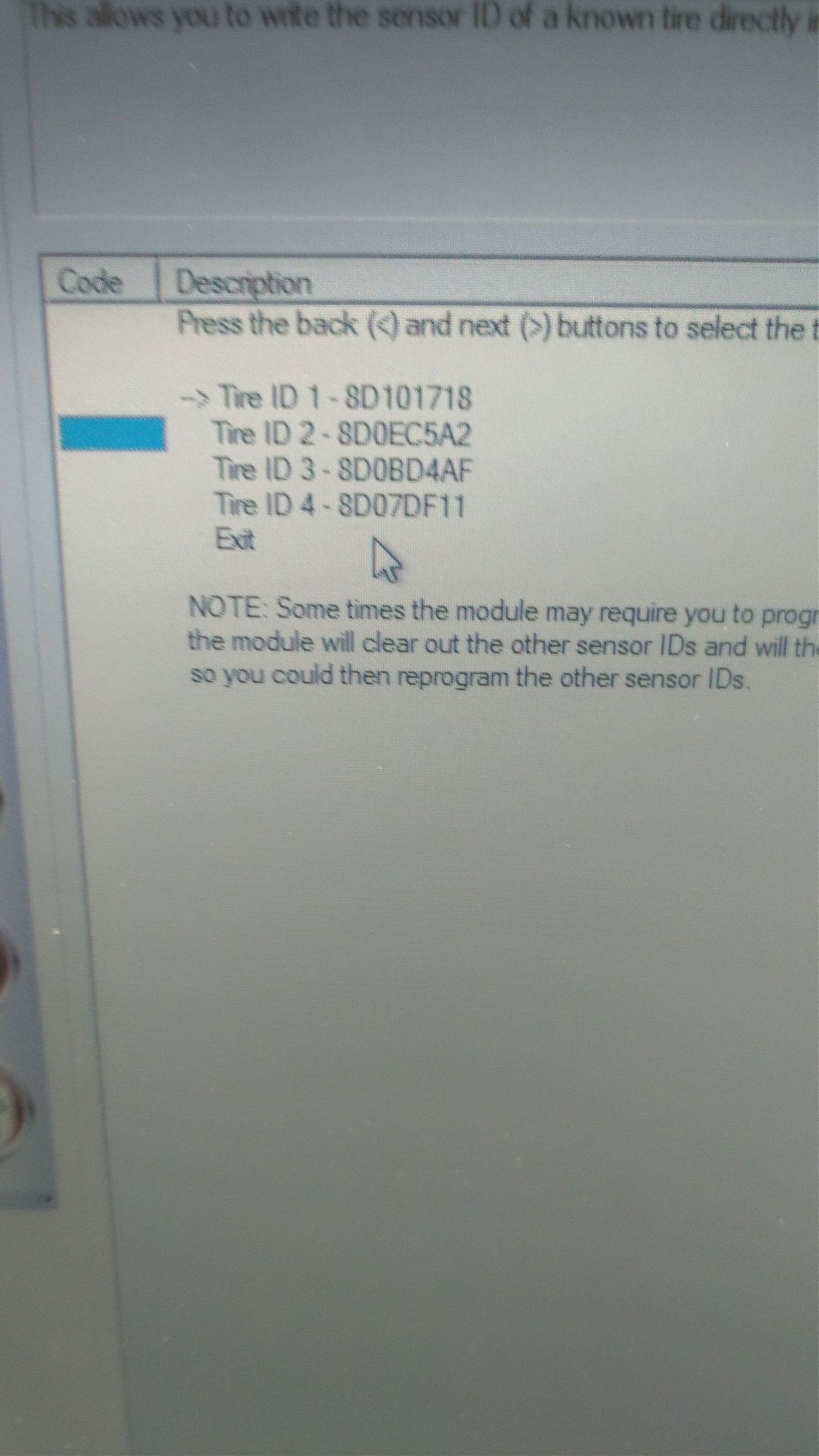

ORIGINAL ID"S
NEW ID's location moved
let me elaborate better ..
Here is the original sensor ID's..
the second pic are after I took it to Dunn tire , minding I didn't change or rotate tires.. just added sensors..
Originally i thought I solved the issue, all sensors are working, but stupid idiot light is on..
Why Are ID's numbers associated with different ID's now on different spots.?
I have no codes, yet the stupid light is blinking , I drove it .. more than 28 mph.. 2 hours with no difference today, at least 50 miles..
I also have a professional Scanner , which only allows me to add ID's thru OBD.. and check condition.. no codes. for TPMS..all are live,
reading..Except I got a stupid light?
I went to Dunn TIRE because I thought I am doing somethin wrong.. but hell now I still have the same issue and thats the ID's..
Touch confused with this HOnda TPMS system.. Why am I having so much trouble?
On my scanner the ID#s are automatically entered in the order the sensors were activated during the learn process. They stay in that memorized order regardless of where the tires are moved to on the car during routine services.
