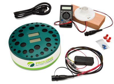

The kit I purchased cost $399 and can be seen here:
https://hybridautomotive.com/collect...ant=5576544132
Comes with everything shown in the picture:
Here's what they say about battery reconditioning:
"The battery reconditioning process is performed by first charging & balancing the battery pack with a Prolong Battery Charger. Then a Prolong Battery Discharger is connected to the battery to provide load and discharge the battery. The battery is discharged well below the level that the vehicle would allow during normal operation. This deep discharge drains the battery beyond the memory effect "floor" to break down the memory effect within the cells. As this happens, material is recovered within the cells and the usable capacity increases. After the deep discharge is complete, the Prolong Battery Charger is reconnected to the battery to charge the cells back to full and rebalance them again. Ideally, this charge -> discharge -> charge process is repeated three times for maximum benefit. Increases in usable battery capacity of 15%-25% or more are common."

I found the instructions to install the wiring harness very easy to follow. The procedure to remove the rear seat, and hook up the harness was pretty simple. I did have to splice their control box into a factory wiring harness, but that too was very simple. The instructions are on their webpage to download to check out: https://hybridautomotive.com/pages/install-c1
The gist of it is that you are charging the battery to full capacity, then letting it sit on the charger for some extra time to let the cells balance. You then discharge it down to .8V. Recharge, discharge to .5V. Recharge, discharge to .1V. Recharge/balance.
This discharging is done with a lightbulb, and the voltage is read with the multimeter already wired in. There is a chart that says what wattage bulb to use for what voltage range you are in. Best is to let the 25W bulb run it down the entire way to the target voltage level, but you can use a 150/75/25 combination for a faster process. You would start with 150W, let it drain to 140V. Switch to 75W, let it drain to 100V. Switch to 25W, let it drain to target voltage.
It's a tricky process that requires you to keep an eye on the multimeter because the voltage can fall off fast. When you get near the end of the process, it can go pretty damn slow. I set up a baby monitor camera to watch the multimeter for me.
My first try doing the bulbs in stages, the IMA light came right back on.
I was sad, disappointed, and mad that I spent $400 for nothing. I gave it another shot, this time using ONLY the 25W bulb and keeping a real close eye on everything, and it worked out great.
- Charging Unit w/ power cable
- Wiring Harness
- Discharge harness w/ multimeter & bulb socket
I was sad, disappointed, and mad that I spent $400 for nothing. I gave it another shot, this time using ONLY the 25W bulb and keeping a real close eye on everything, and it worked out great.If you have any specific questions I'll do my best to answer them.
