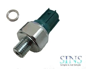

Replaced that bad boy and I'm good to go.
For others who run into this....
I found it easier to put the front left up on an jack stand and remove the tire. This gave me a bit more access to the sensor as it's a pain to get to.
part number is 28600-RLC-004
and looks like this
I used a 7/8" wrench
Thanks again!
