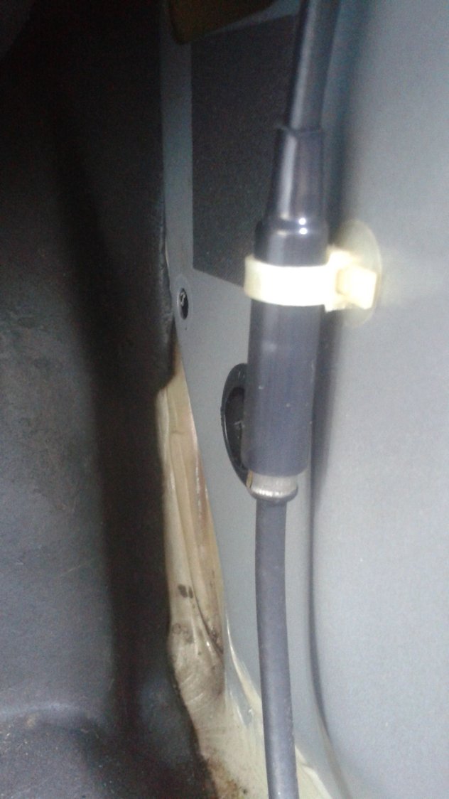

I own a 2012 Honda Civic EX and also has a leak in the passenger footwell. I pulled up the mat and see this black plastic casing. I pushed down on it and water comes out. Does anyone know what this casing is for and how to remove it and what might cause a leak of water into it. The leak is from the rain. Any ideas are appreciated. Thanks
Attached is a picture.

I think that black part in the pic is the firewall sound deadener. It's like a layer of rubber with half inch thick wool felt under it, and it soaks up a LOT of water.
That sound deadener itself cannot leak, it's simply pushed up against the firewall before the dashboard related stuff was installed. Leak has to be coming from somewhere though.
Has it ever had a windshield replaced?
Stereo/amplifier hot wire coming thru the firewall?
See if the drain hose for the evaporator case is detached.
See if sunroof drain tube is out of place allowing water to reach the floor.

When I hosed the right side of car/windshield, I noticed the leak in the corner where the yellowish section is, up behind the black plastic. Any ideas? I didnt spray the sunroof.
Thanks in advance.
You'll have to follow it to see where the water entry starts at.
Or wet small specific areas on the outside, to figure when water starts entering the inside, that might narrow it down to a smaller general area.
Wiper cowl panel area? Fender area?

Only far enough to figure out where the leak comes in, not peel the entire layer off....that probably would require pulling the entire dashboard out.
Pull up what you can and hold it out of the way so you can see if water enters somewhere it was covering
Flop open the glovebox all the way to the floor and peep around the blower housing and air intake area where the blower attaches to the underside of the cowl area. Use a good flashlight, have someone else hose down the outside while you watch from inside?
