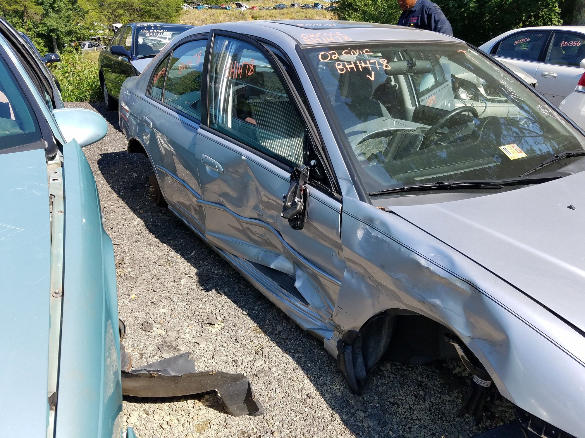

Anyway long story short- with 210k miles overheated in August when it was hot. I finally traced it down to a dead radiator fan, in combination with a really hot day and my relative still driving the car. It might have also been head gasket but I'm not sure which came first- water under the bridge at this point. It got so hot it melted the plastic timing cover and other parts. Had to be towed. As many of you know, for this gen car, most boneyard engines are 100K+ miles, but I got lucky and found a good deal on a 02 junkyard motor with only 32k from one that was hit on the passenger doors- so it was in pristine shape, decided to get the transmission too. Was about 150 miles away but a fun little road trip. Did some work on the replacement engine while it was out of the car, including changing the timing belt and rear main seal.

Donor car
At the bone yard collecting the loot
