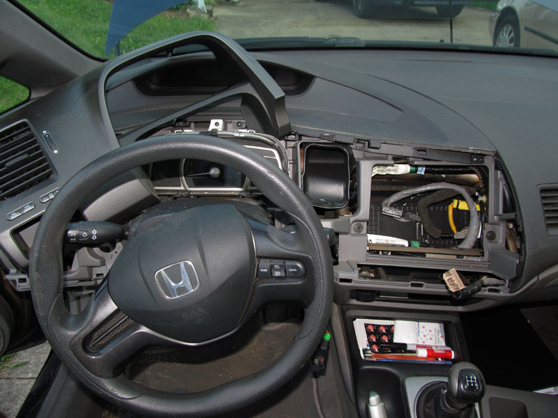

Sooooo time to take the dash apart. Diassembly is NOT OBVIOUS! Thanks to youtube there were 2 videos showing the order of parts removed and where the three hidden screws were. Easy to find so I wont post a link.
I removed the airbag light, flasher switch and ac/heat controller and plugged them back in to operate the car. I thought I might find something like a bad switch for the AC on/off, but the switches are surface mount so you cant make a repair. I did observe when I turned the key to on with the heater fan off, the rad fans would come on. Key on and heater fan on the AC fans shut off. Engine on and rad fans and compressor were back in action.

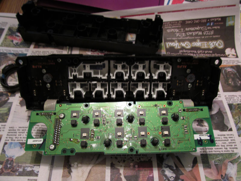

I did some disassembly, but there is nothing to fix except for two burned out indicator lights.
