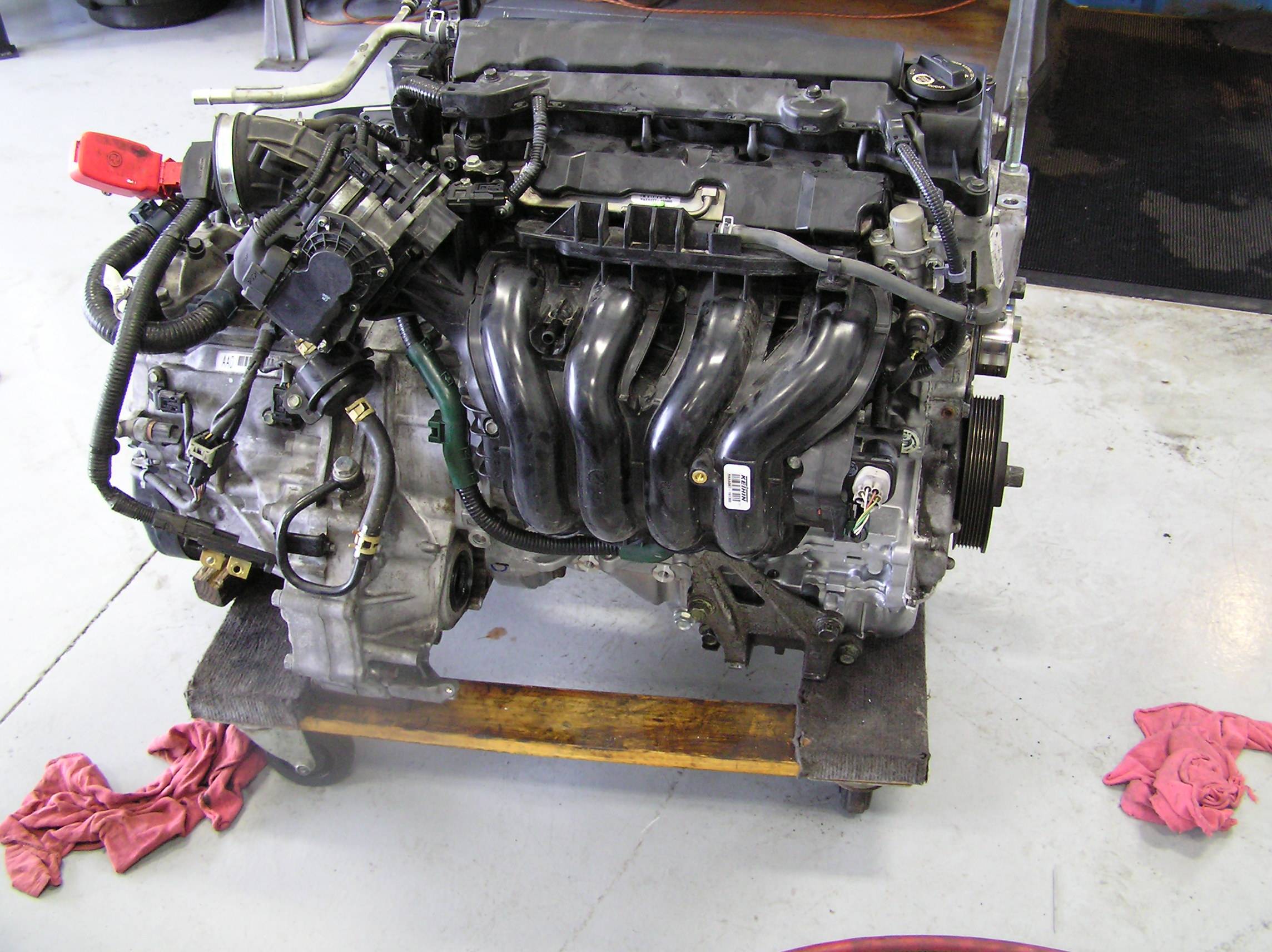

Handy pic of the drivetrain backside for trans filter location:

Is this the filter? See attached.
Is it easily accessible and changed?

That is it.
R&R calls for removing the airbox to access it.
