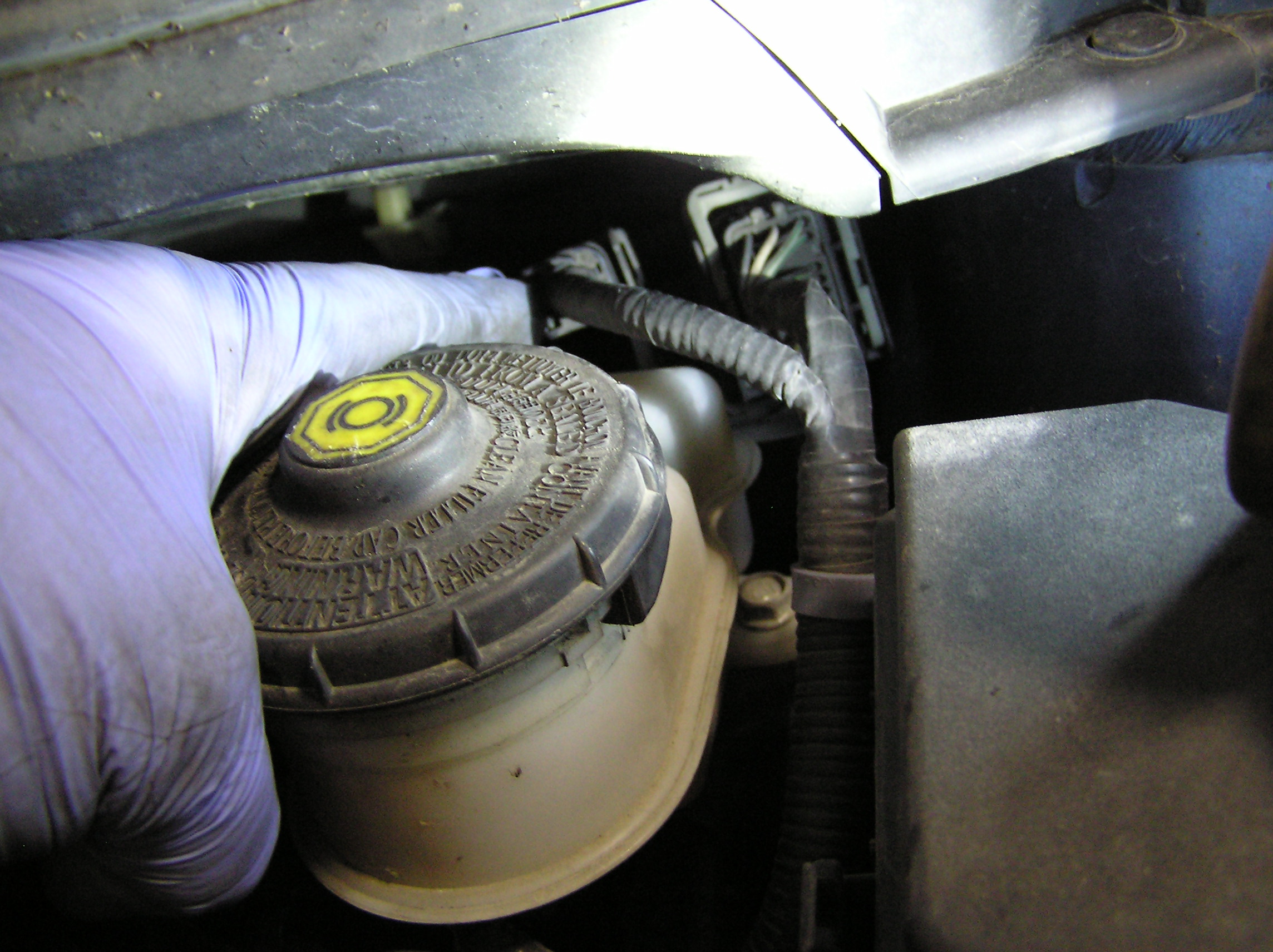

Sorry if this is too late to help...
Got a pic at work today.
Look just behind the brake fluid reservoir.
(I'm too lazy to resize pics.)
Find the single wire that I'm pointing to, unplug it.
The half you pulled toward you leads to the starter.
Put the car in Park or Neutral, pull up the handbrake!
Use a jumper wire to briefly connect battery positive to that wire, the starter should crank the engine IF the starter is still good and battery and cables, etc., are ok..
If that makes it crank, the problem should be somewhere inside the car (ignition switch, clutch switch, relays, etc., varies on each car). If it doesn't crank, the problem should be in the engine compartment (battery cables, starter, wiring).
