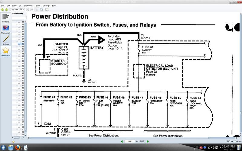

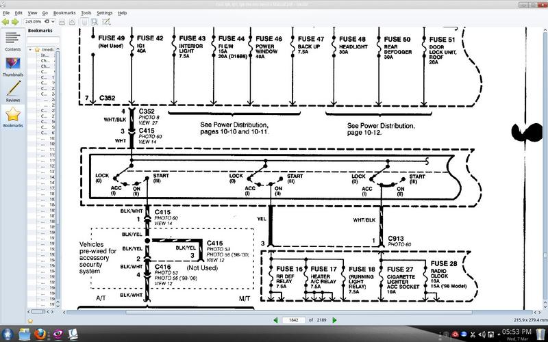

Re: Do I need a relay?
Your fuses will tell you the amperages.
Name:	Civic1999 - Power Distribution.jpg
ID:	82699   Click image for larger version
Name:	Civic2000 - Power Distribution - pt2.jpg
