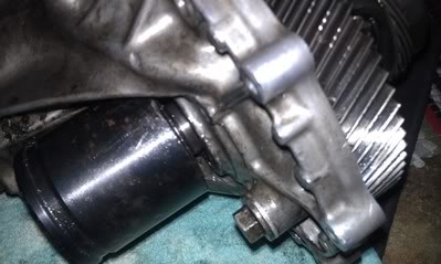

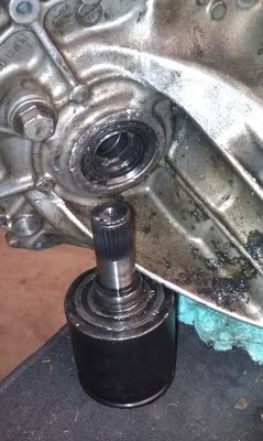

so i picked up that tranny for 150...
Any ideas on how to get the damn axle out? i can try to post pics of it later..
Could I try and force out pins in the diff? Or are they locked in with threads?
I want to avoid attempting to cut it...besides, it appears that its pretty hard, thick steel...
Ideas?

Re: axle stuck in the differential?
I thought ideas were like a$$holes...everybody has them! lol...
So c'mon guys! What's the dilly, yo? I understand the lack of photos may stump people. I'm realizing my cell phone internet access can only do so much...maybe time to spring for REAL internet access on my computer Lmfao!
So in light of that, standby for pics...I'll try an upload some at work tomorrow.

Old Feb 11, 2012

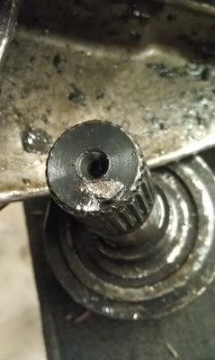

Sorry for the long response, my work internet SUCKS!!
o4 civic- its all good man, I asked for opinions, right?! LOL
sdaidoji- im with you..was worth the risk for the price! If I can get the axle out and all the internals are good..... and all the rest of the parts are actually there an I didnt get juked...i could have a rebuild for 150?? Hell yeah!
shoot..lol how could we take a vote on it?
Stuck and f**cked... or easy fix?
some pics:
disassemble the differential until you can see the tip/edge of the axle? Not sure if that is possible, though.
have you looked at this pictures from bomerman?

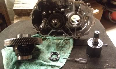

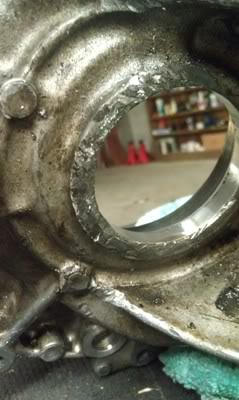

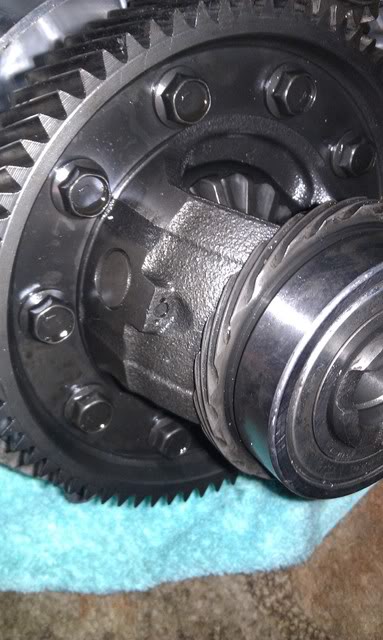

Hey!
So I got it all apart pretty easy, actually...First I pressed the diff bearing back into the housing..then I worked a pickle fork around gently on all sides of the axle, tapping it out with a rubber mallet. It came out pretty easy, once everything was aligned again (it had had been whacked crooked, pretty violently LOL...check out the pics:
this next one I think dude tried to punch it out with a screwdriver, through the middle of the diff..

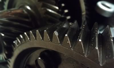

And this is what happend to the teeth on the ring gear, from all the whackin on the axle:
I may unfortunatly have to replace the gear, accoding to the CEO of Synchrotech LOL...What does civicforums have to say about it? Replace? or ya wont notice..
And let that be a lesson to all those axle whackers out there...if its stuck, coax it out gently...this was not a time for the BFH, LOL.
Will keep ya'll posted on the progress....
Old Feb 18, 2012
Posts: 15,193
Likes: 1,610
replace - that's a part you don't want to take apart so oftenand might compromise the other gears and leave small metal inside the fluid.
Congrats for taking it out!
150 was well worth the risk!

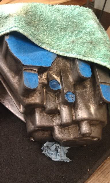

anyway, thinkin about painting...like blue or...green..after I clean it.
Speaking of which, brings me to cleaning questions...whats best? Im thinking combo of chemical and mechanical (as in wire brush)...but what fer chemical (as in degreaser???)
normal engine degreaser? (while everything is out of teh case? Not sure, maybe a internet search on potential issues for degreaser in transmission?)
