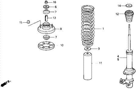

Probably the top mount bushing(s) but, it could be the mount itself (#8). Also, make sure the bolts on top of the strut tower are tight.
Check numbers 7, 10, and 12 as well as 8:

I checked all of these bolts and they are all tight. I also looked around the LCA's bushings, which i changed and I don't see any marks or any signs of movement on any of the bolts or nuts. I am really stumped on this. It is only the front end. Here is what I have changed on the front:

Read post #5. Yes, you have to take the strut assembly apart to inspect. A spring compressor is required.
