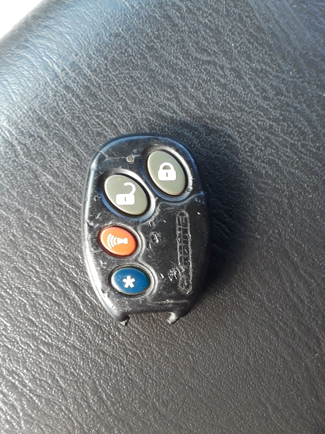

Re: Door popper faub is gone for my 2000 Honda civic
this is the key fob. it just quit working completely. I changed battery and it didn't help. I seen a guy on YouTube put tin foil inside the key fob where the buttons are and that didn't work. now I'm going to try to locate the box for the door popper but I don't really know where to start.
box meaning control box/module?
check in the kick panels or in the dash, if you see wiring that looks non-factory try tracing it back.
If you can find the module you can get a model number off it, then you can probably download the instruction manual and possibly order a new fob.
if you can find a model number on that fob you can try searching that and seeing what you come up with.
I'm wondering if they used a remote start module and used the door unlock output signal to activate the door popper

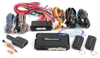

Re: remote is gone for my 2000 Honda civic
the module will look something like the box in the middle, the antenna should look like the black thing on the left.
if you pull the lower dash cover and the kick panel off and start looking around with a flashlight you should see it or see the spliced wires
