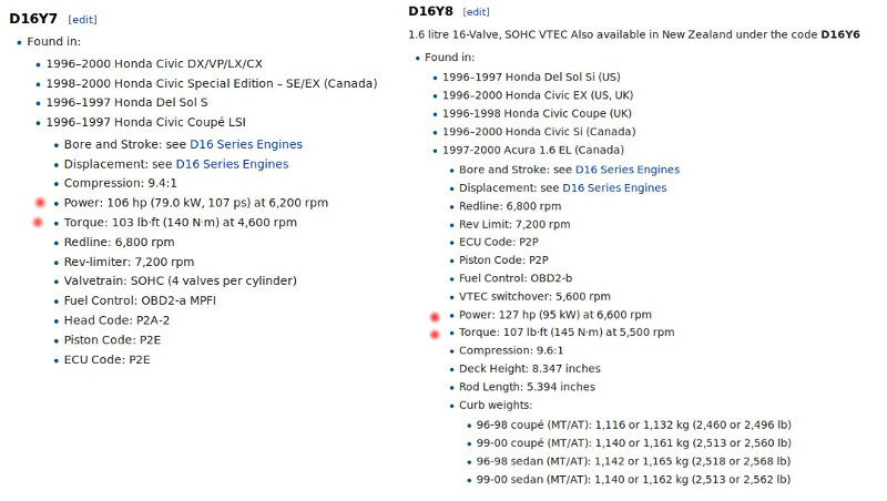

I got a 98 with a d16y7 I wanna put the y8 head on. So far I got the head, intake, throttle body, p2p ecu, and a full wiring harness from a ex. Curious what else I'll need to make this work. Any mods I might have to make. And is it worth the time and money to do it. At the very least imma put the intake on but I'm unsure about the whole mini swap. All info and advice would be nice.

When I first bought my Civic I looked into all the fun things I could do to it including the mini me swap. It seems it's probably the biggest HP gain for the Y7 engine...essentially turning it into a Y8. If you have the tools, the confidence and the skills to change a head gasket then it should be easy. Seems that you already have the parts you need.
I haven't done it myself but I googled the info last night and it's readily available online. Some people debate over whether you need to add a knock sensor and use the Y8 injectors but it's your car I guess you need to make those decisions for yourself.

Yea doing head gaskets ain't nothing. I've done them before. I know it will pretty much bolt right on. But I'm not sure if I had everything I needed or not. When I do the swap it's gunna be a one day thing cuz it is my daily driver but I want some more power from it. I looked for the knock sensor based off the location of the y8 setup and it looks like I already have a knock sensor on my y7 block. Why i dont kno it doesn't make any sense for me to have one since my valves ain't variable. But it looks like it's already there. But I was also curious what kind of gains to expect to see if it's worth the money. I still need head gasket, timing belt water pump, new exhaust manifold, manifold gasket, intake gaskets, throttle body gasket, a new air intake, etc all the little ****. But that little **** will add up. Since I got all the other parts from a friend I haven't paid for them yet and can return them if I don't do the swap.

Statistically there is a 20 hp difference from the y7 to the y8. Most people who report hp gains are using their butt dyno which is notoriously unreliable.
If I needed to do a head gasket replacement I would definitely consider it but otherwise I'm a 'if it's not broken don't fix it' kind of guy.
