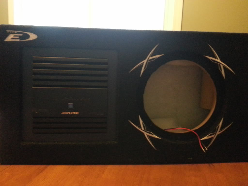

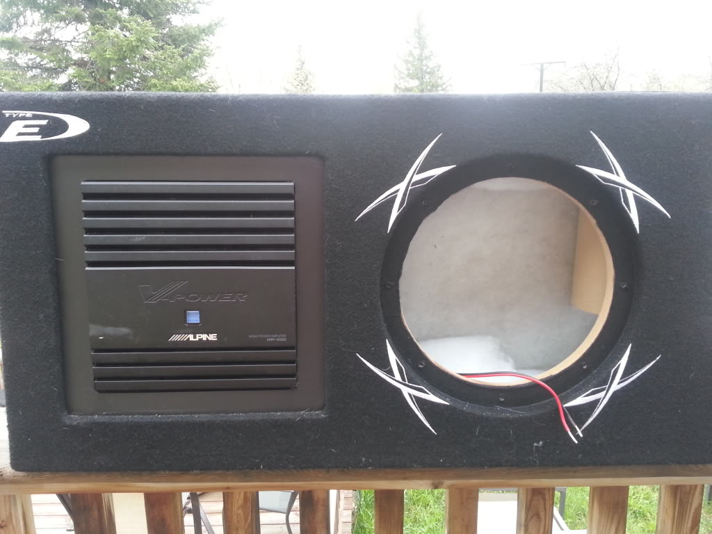

Alright, so my sub stopped working the other day. No worries, it wasn't that great anyway, and I had planned to replace it!
Now, I have a problem. My amp was mounted in my sub enclosure, and I can't seem to get it out. Do any of you know how to get it out?

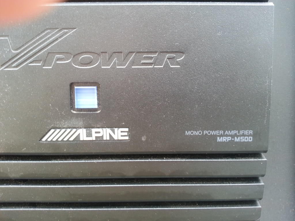

Also, what kind of amp is that? "Alpine ______". I need to know, because I have to find another amp the exact same size as that, to mount in it's place.

I'd bet the speakers and amp were mounted on the board before the board was screwed to the rest of the box. I'd be feeling for screws all around the edges. Maybe peel the fur back to find screws.

The amp irks me. It looks like it's an Alpine v-power MVR-M500, but the mounting holes are missing. That, and it's very slightly different than every other m500 I've seen. Also, if the "Type-E" at the top left corner of the box is any indication of what sub used to be there (Alpine Type-E 10", I assume?), then it was being overpowered.
If that's the case, I'm willing to bet the amp still works fine, and the sub just blew. If you look at the amp, and straight to the right of where it says alpine, there's two lines of text, the bottom of which should be the model number.

Also, is the amp any good? This is the wording on the amp: Alpine V-Power Mono Power Amplifier MRP-M500. If I keep the amp, will I be able to get a good sound output from it?

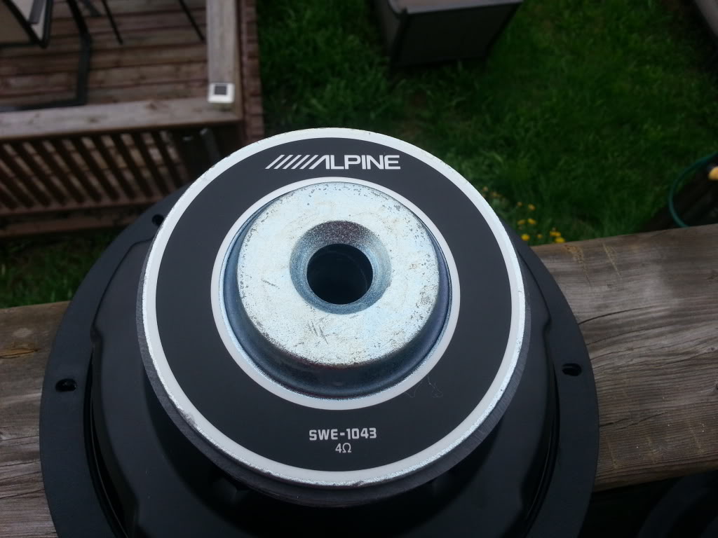

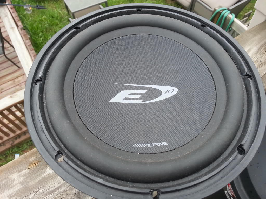

Also, yes, it was an Alpine Type-E 10" sub that was mounted in the hole.

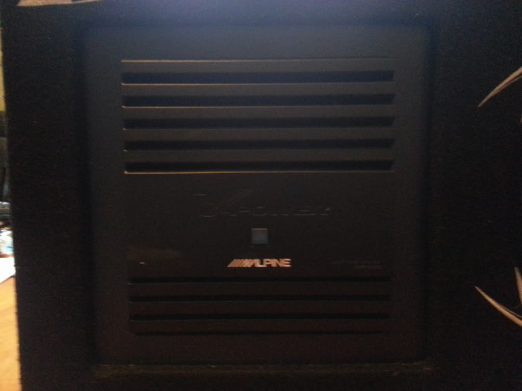

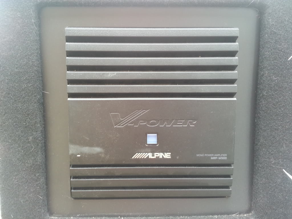

Gym got postponed.. Here's some pictures!

Hope these help a bit, any advice will be greatly appreciated! I don't know a whole lot about this stuff :P

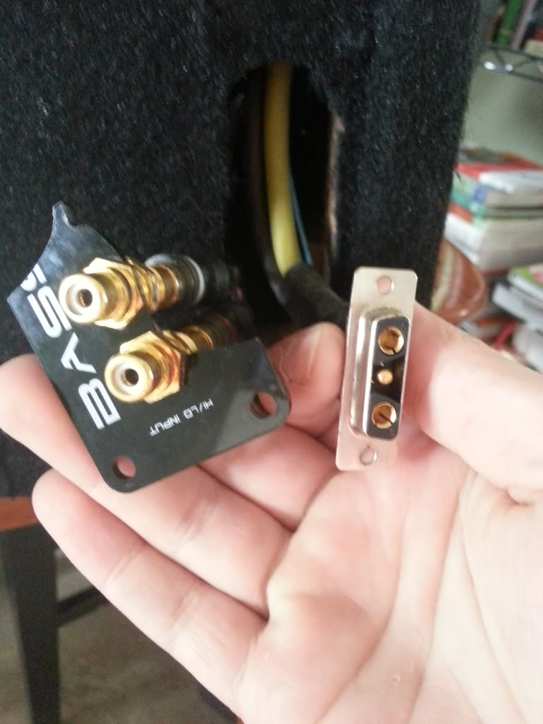

The cord on the left is what I normally use to hook up the amp. As I was looking in that hole, I noticed there was a cord tucked away. I pulled it out, and it is the cord on the right. What is that? Could it be the answer to my problems? lol

As for that cable you found, see if you can follow it to see where it goes. If that supplies voltage to the amp then that could be your issue.

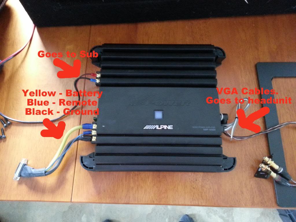

I got the amp pulled out. I just had to pull that rectangle bezel out, and the mounting screws were behind that.

I labeled what my amp said all the wires were. So, if I run the VGA to my headunit, what do I do with the other one (the one I found tucked away)?
I have a bunch of fuses, so I'm going to go ahead and replace both on the amp, where would I find the fuse that goes to the amp from my battery?

That cord that was tucked away, is supposed to go to my battery, and I wasn't using that. All I did was run a cord to my headunit.
I'm heading to The Power Center right now to get a power cord for it.

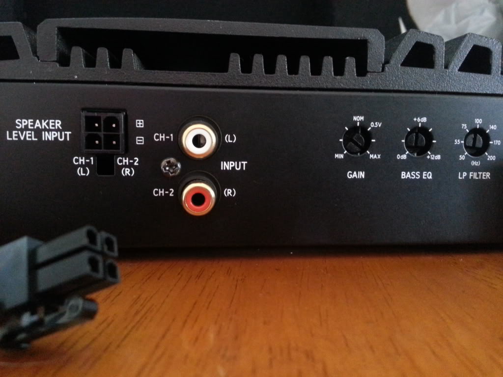

Now that I have it out though, I can mess around with it's settings. Here's a picture, what do you think I should turn the things to?
The gain, bass eq, and lp filter is what I'm asking.

I listen to a lot of country also (and rock) and my bass boost is turned down rather low. Your going to have to adjust that **** until it sounds good (don't want to drown out the lyrics and guitar). The gain is set with a voltmeter and the LP (low pass) is set to the subs frequency range and the frequency that you want. I set mine to 50Hz. You use a test tone for this which can be found on YouTube.
Gain and frequency settings are part of a sub's specs.
