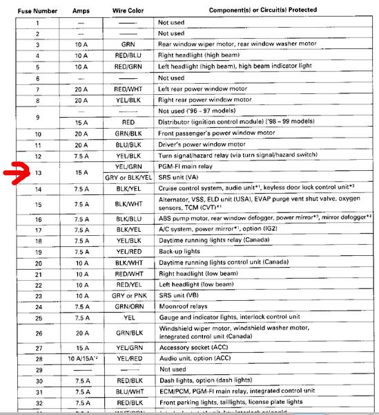

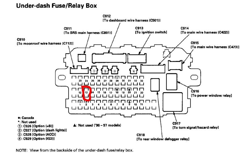

could try this...
ID:	84605   Click image for larger version
